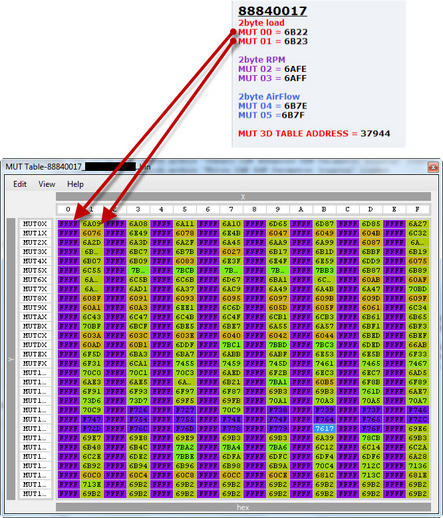

When I try to log load with Evoscan V2.9 the load 1Byte is always "0" zero.
I searched and I couldn't find anything related to my rom version but it's mentionned that I need to modify the MUT table but ... what , where ... .
Please advise

From: Lebanon
To begin with "Merry Christmas to all".
Then you can find attached my MUT table and in the link you've sent me you can find that i should change:
88840017
2byte load
MUT 00 = 6B22
MUT 01 = 6B23
2byte RPM
MUT 02 = 6AFE
MUT 03 = 6AFF
2byte AirFlow
MUT 04 = 6B7E
MUT 05 =6B7F
My questions are:
>> I f you look at my MUT table you can find that the bMUT 00 is FFFF , what should I change .I tried the MUT 01 the values are wrong while logging.
>> To log load should I change the RPM and Airflow or only load?
I need your help cause I'm facing lots of knock and I need to do it the right way.
Thanks in advance for your help or suggestions.

definition file is incorrect for the static values for mut
it should read -0-1-2-3-4-5- etc
remove current and add this to the evo9 Base xml
