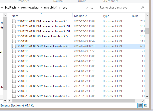

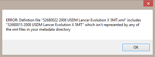

I have two problem with live tuner
The first one.. I have this error
But my 52680015 ROM is already in my metadata directory
Any idea what the problem could be ?
I just download the latest version of the rom but live tuner can't see it ?!?
Same thing with an older version
________________________________________--

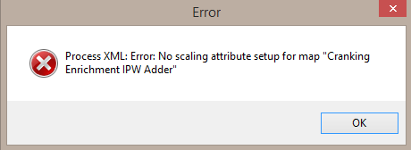

Second problem.
I tried to open the map of my friend and get this message
There is a part of the original XML
<table address="5750e" name="Cranking Enrichment IPW Adder">
<table address="61934" name="Coolant Temperature"/>
</table>
And this is in Tephra's XML
</table><table name="Alternate #1 Cranking Enrichment IPW Adder (Main)" scaling="TimeInjCranking" type="2D" address="f1676" category="TephraXMOD V2"><table name="Coolant Temperature" scaling="Temp" type="Y Axis" address="61934" elements="9"/></table>
There is alternate 1 to 9
and..
<table name="Cranking Enrichment IPW Adder" lt-memory-blk="80c030" lt-group="0" lt-memory-ptr="805040"/>
I really don't understand what's wrong.. I can attache the XML if needed

try updating ecuflash, i think some of the recent ecuflash's had XML's which incorrectly "included" the other XML's.
with regards to the LT error, your table names have to match perfectly, in your case they are, but because the XML's arn't loading properly (see error #1) then thats why its throwing error number 2.
try updating ecuflash first, if that doesn't help you gotta fix the includes.
ie 52680022.xml needs to say <include>52680015</include> not <include>52680015 USDM blah blah blah.xml</include>
