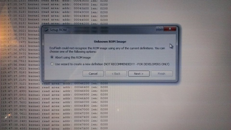

It says I'm running 96930011
That's what the identifier says.
I read that with evoscan. But idk if get is right. From what I read that's an Evo VIII identifier and I have an Evo IX like you.
I had no problem with evoscan reading my Ecu.
The problem I have is openin it in ecuflash. I always get the setup rom window
