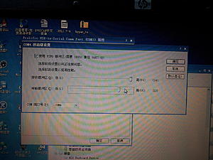

Old May 3, 2014 | 04:04 AM
wenjie1812's Avatar
Joined: Mar 2013
Posts: 21
From: china
Originally Posted by ehall20
Problem solved! For anyone reading this thread in the future, the problem ended up being that I needed to plug the Tactrix cable in at the same time as the serial cable coming from my wideband. Thanks for the help.
Need help AEM UEGO serial output EVOSCAN LOG
I according to xPRimNT tutorial (http://www.evoxforums.com/forums/showthread.php?t=21747)
Use hyperterminal communications test everything is normal.
Check on EVOSCAN match COM.
But when use EVOSCAN record AFR to 0.
This is the reason why.
You can use images express the way you solve this problem? Thank you very much!

Old May 3, 2014 | 07:37 AM
jrainwater's Avatar
Joined: Mar 2013
Posts: 890
From: Chicago
That blue cable you are using sucks. I used one for a month and it died. I went to microcenter and bought a highend RS232(DB9) to usb adapter and if works like a charm now. Measure the voltage at the RS232 before the usb and see if its seeing voltage. If so its that cheap blue usb adapter you're using. It was my issue.
