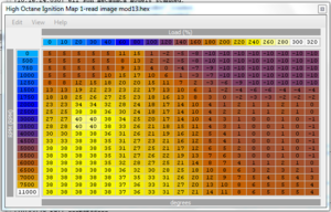

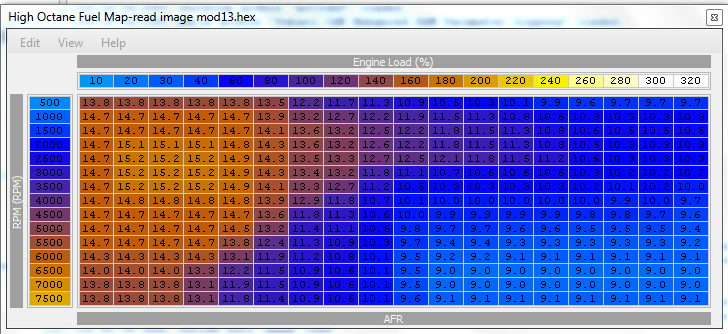

Originally Posted by ReaperX
Post a screenshot of the timing map please. Also what are you using for boost control, and does the wg actuator have any additional preload in it?
Thanks for your time, Shaun. Boost is controlled with ecu; no mbc or other add-on. I don't know about the actuator preload. How can I find out?
I'll post the high octane fuel and ignition map screenshots here for the above log. Then, I'll post them as they were before turbo change below.
Attached Thumbnails crazy timing jump in log-mod13.png   crazy timing jump in log-mod-13-fuel.png

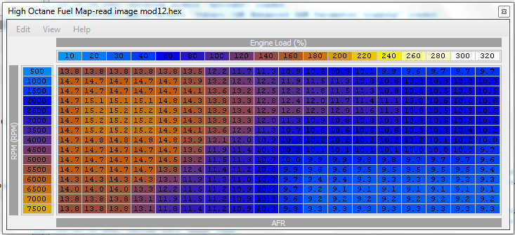

I had really cut back on the knock by decreasing timing advance before the turbo switch, but I was still getting just a bit. Here is a message I sent to my mechanic at that time:
I had dialed the timing back in a few of the load cells based on the previous logs that I posted on evolutionm. I took it out to log again and for a while I thought I wasn’t going to be able to get the cel to flash at all. But, it finally did one time. When I looked at the logs, there were multiple instances of 1 or 2 knock counts, but only one line that had 3. (That answered my question, I think, as to whether it flashes with only 1 knock, or whether there had to be 2 or 3. Looks like 3.)
I feel SO much better now. I’m going to Barber next weekend, and I was afraid I’d have to cancel with the way it had been knocking. Now, even if I can’t get into the ecu again, I think some octane booster and race gas will keep me safe for the weekend.
The part of that log with the 3 counts is attached.
I saved the attached maps the next day, and I'm pretty sure I was able to flash them into the ecu. So, these would be the maps that were in the car before and after the turbo switch. (Even with adding Torco to boost the octane, I still got a little cel flashing at the track.)
I'll post the logs of the car with the replaced turbo in the next message, in chronological order.
Attached Thumbnails crazy timing jump in log-mod12-fuel.png   crazy timing jump in log-mod12.png

So here is the first log with the turbo replaced, with the maps mod12 above (EvoLog1). Then, I took some more timing out, flashed the revised map back in, and recorded the second log (EvoLog2). I didn't save that revised map.
Before the log attached to the original post above was taken, I decreased the AFR by 0.2 in all the cells with load >100 and RPM > 2000. Then, I saved maps mod13, above.
