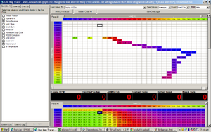

This is where I can run very consistent without any knock.
Here's my map trace.
And full map.
Let me know what you think. I'm probably just getting greedy and wanting more out of a very stock car. Tunah has suggested that I'm just at the mercy of my exhaust. I tend to agree.
The car feels great, but that flat spot in the power from 4800-5800 is driving me crazy. I can't run any more boost or timing without getting knock.
Let me know what you think! I can post the log if necessary.

Are you on 93 octane? You should hold 24 psi boost out farther, its drops off a lot after 4k rpm. Your timing looks pretty low, especially for an 8. I don't see why you would be getting knock with more boost and timing, are you sure its not phantom?

Have you tried to see if it would take a little more midrange boost if you lessen the initial spike? Just thinking that it may be too aggressive down low and that is maybe causing problems in the mid range. Just a thought. But Id ****** that exhaust off there ASAP.
And just be careful comparing VD #s to other people's graphs. Who knows how accurate they are. I know I do mine in the same spot, both directions...and still really only do it for comparison against myself.

I'm still toying with it. I was getting some knock at peak boost and it was really frustrating me. But it turns out it was wanting more timing instead of less, go figure. So, just going to bump it a hair and keep my timing advance good.
I don't know that I'll necessarily make "300", but I've also been comparing against some of my old pulls (one that I sent you) and have been using the info to edit the tune.
I'll keep you guys posted. Thanks for the input.

So, with the catback, test pipe, and some cooler weather, the car has come alive.

I'm sure there is still some timing in there, but I'm happy with it for the time being.

Pretty stoked. She took another degree of timing 6000 and up. I'll try to get a pull in after work and see how it looks. But, I think I'm happy enough to spend some time on suspension for a bit, now. Of course, I'll have to get a downpipe or larger FMIC on by next summer. I'm not going to want to give this up.
