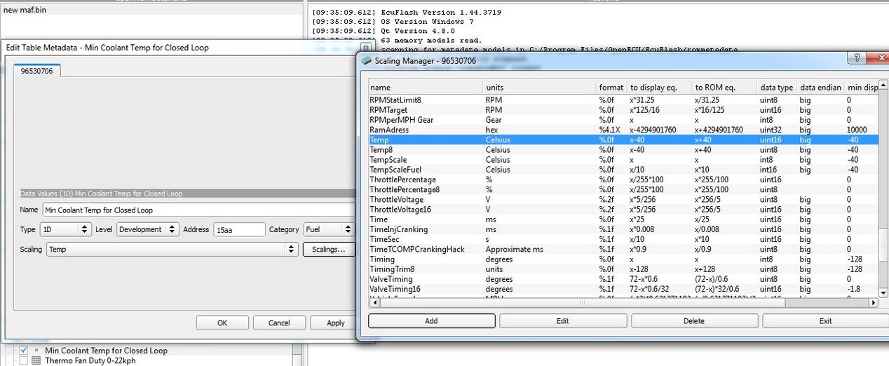

stunt2's Avatar
Joined: Nov 2010
Posts: 753
From: Georgia
Originally Posted by merlin.oz
for 9653, closed-loop temp is at 15AA (16 bit) or 15AB (8 bit)
check your temp scaling to see which you are using.
is my scaling wrong ?
Attached Thumbnails Tephra Rom ignoring "Closed-Loop, Min Coolant Temp"?-untitled.jpg
Old Sep 20, 2014 | 02:53 AM
merlin.oz's Avatar
Joined: Jun 2008
Posts: 824
Likes: 24
From: Sydney
stunt2, that is a normal 16bit scaling, so use 15AA
