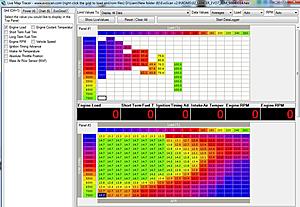

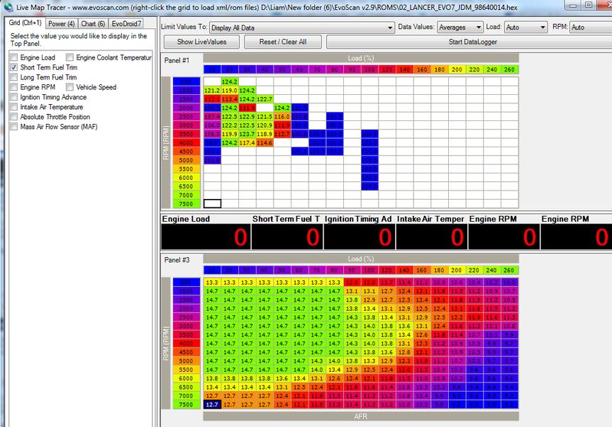

My STFT's are coming up as ~125 in Evoscan 2.9, which explains why the AFR is like 10.5...

The two wire is likely dead, and even if it isn't it will take forever to heat up and start reading properly. In the meantime the ECU will be getting a lean signal and increase the short term fuel trim to compensate until it maxes at +25%.
If you log o2 volts you will see that the voltage is reading like 0.1V or less.
