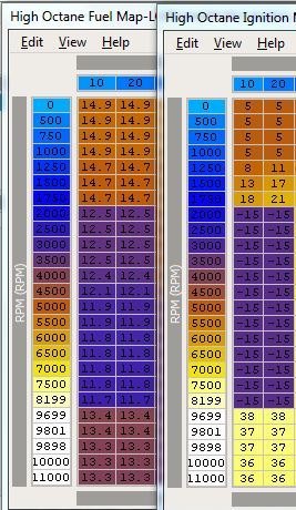

I missed my srt4 pops, so I added them to the evo! What do you guys think? Any worries about the negative timing messing up the turbo in the long run (like anti lag use)?
Since I had a heck of time trying to find what other people did with a video to go along - Here's my info for others that may be interested, this is all I had to change. Just a little negative timing and more fuel:

Damn.. Now i'm scared to do this lol just got rebuilt a little while ago myself
Probably not the cause. I've done some horrible things to my car testing the anti-lag systems including make my own fresh air system, jacking the throttle and an entire main timing map of -20.
FYI you can make 30psi stationary with out using a fuel or spark cut limiter. It will sounds like a jet engine spooling up. And where you hold your foot determines the boost.
Then I got an a vipec standalone. torture went overdrive.

So I just got a 1.3u cable and all you did was modify those tables?

Really nice, is it possible to activate it via a Switch (eg. Intercooler Sprayer Button?).

You can use alt maps for this
Could you elaborate?
Tephra V7 has Alt maps (alternate maps) thats actuated by a switch. Allows you to switch maps on the fly.
For example, it can be your Race gas, e85 map or whatever you desire to use the maps for.
