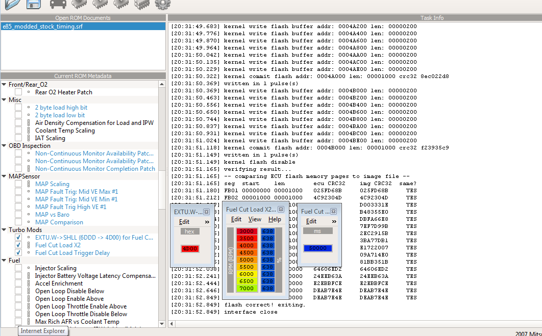

Nevertheless, I followed the procedure to increase the load limit as documented by mrfred here:
https://www.evolutionm.net/forums/ec...nge-638-a.html
No help. Still hitting fuel cut. I made sure that I grabbed the XML for my ROM. I double checked that the settings are correct but I'll post them here for verification anyhow:
Need help with fuel cut [logs/pics inside]-pif5de4.png

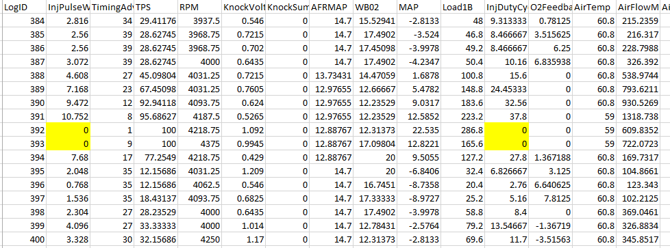

Here is an isolated occurrence. You can see the fuel cut in yellow:

And here's another occurrence, where I encountered fuel cut, backed off, then induced fuel cut a second time and held WOT to see if I could glean any extra information out of the logs:
Need help with fuel cut [logs/pics inside]-r3zspgf.png
Has anybody encountered something like this before? Fuel cut below 319 load that doesn't respond to the fuelcut X2 patch?
