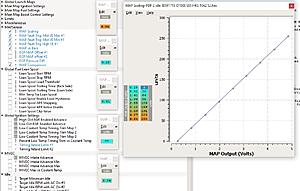

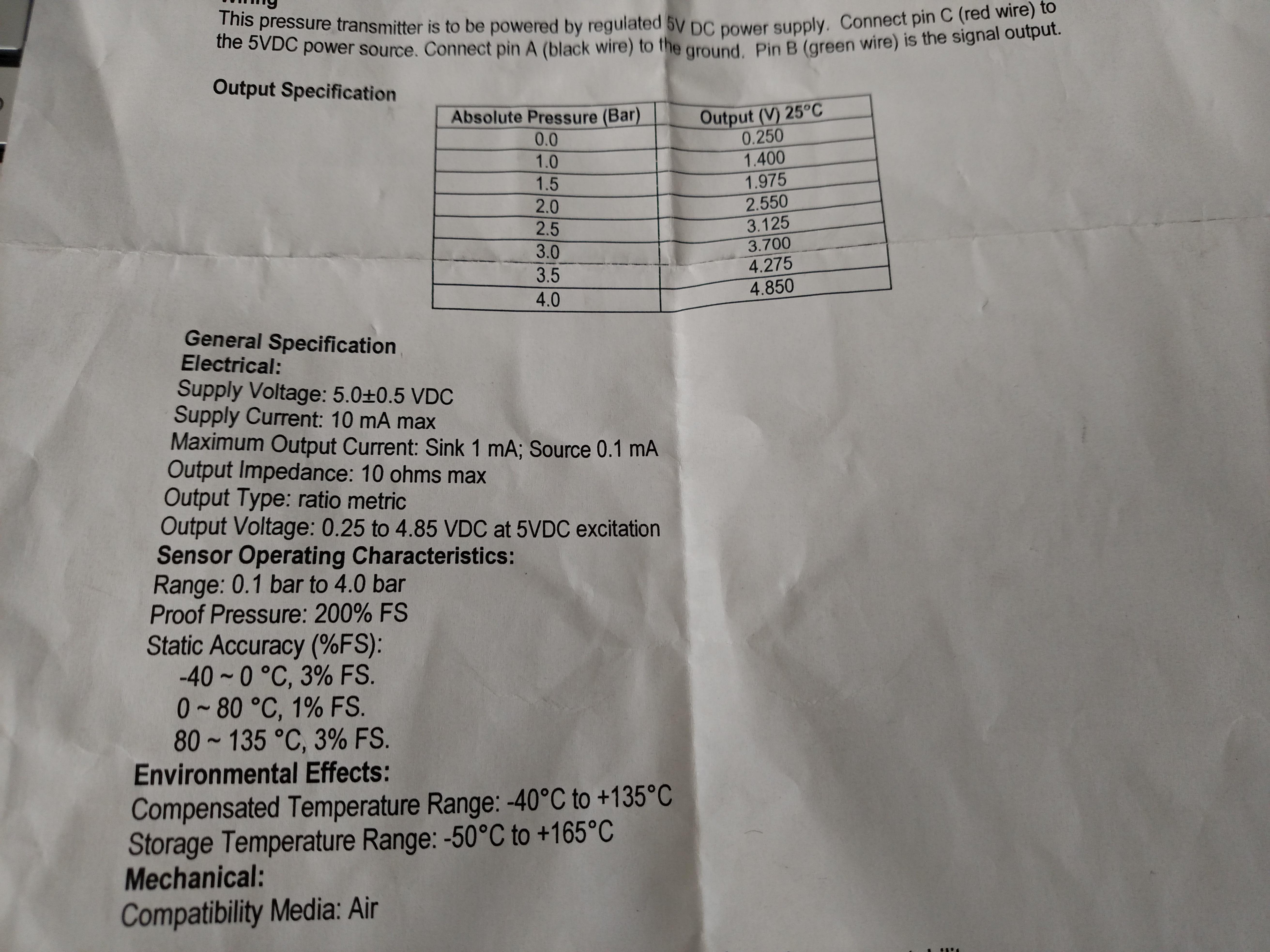

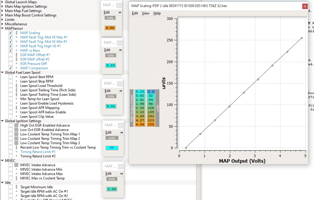

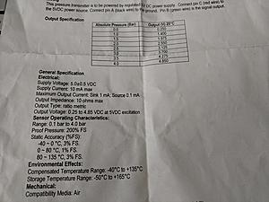

I've had great luck with OmniPower 4 bar MAP sensors for 8 years. However, recently a handful of bad ones popped up and I just want an option. I'll probably continue to use the OmniPower sensor since it's a lot easier to install, but I want to have an option when one goes bad.
Anyhow, I'm trying a GM 4 bar MAP sensor now. I used the Omni 4 bar settings and it seemed to work OK. The scalings I'm sure are different and logging shows there are some differences. It could be the evoscan formula needs tweaking and/or the map settings in the ROM need adjusting.
I tried going off the spec sheet and it seems to make sense, but this isn't my forte. I also searched, but come up with a lot of GM 3 bar sensors.
So, I need the settings for the rom, scalings for the XML (SD, map sensor, boost control, etc.) and for Evoscan.
Thanks in advance!
