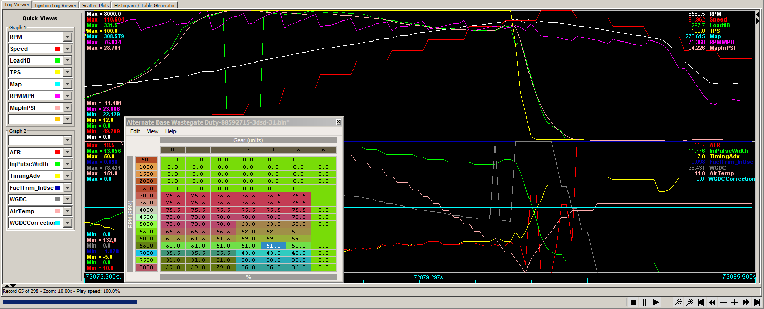

I have been trying to bump up the boost on my car but for whatever reason the wgdc isnt following the table accurately.
car is evo9 8859 3d sd rom on 93 octane
Boost error correction is zeroed out
Maf IAT table is untouched from how i downloaded it. the scale is 14-95 f and my iats are 144 so it *should* be at zero adjustment.
attached is a screen shot of my log. it shows zero wgdc correction throughout.
some quick data:
rpmlogtune
50004863
553147.562
60314559
65623851
70314333
has anyone run into this before?

I have continued to play with this a little and i cannot get the wgdc to match my set table no matter what i disable.
Is this normal or am i overlooking something?
thanks

mine is a ebay tial copy gate, but my underlying problem was unit conversion.
i converted from logging with evoscan and a tablet to standalone logging with the openport 2.0 and had a few hiccups along the way.
now that its working, i like it 1000x better.

I grabbed a logcfg.txt file for my openport and a bunch of the scaling in it was wrong and i initially made the improper assumption that it was all correct. once i realized what was going on, i went back and had to correct quite a few of the entries. for instance, my 144* iats mentioned in the first post were actually only about 70*
now it all works well, and i even just switched to a 5 bar map since i was flat lining my gm 3 bar.
