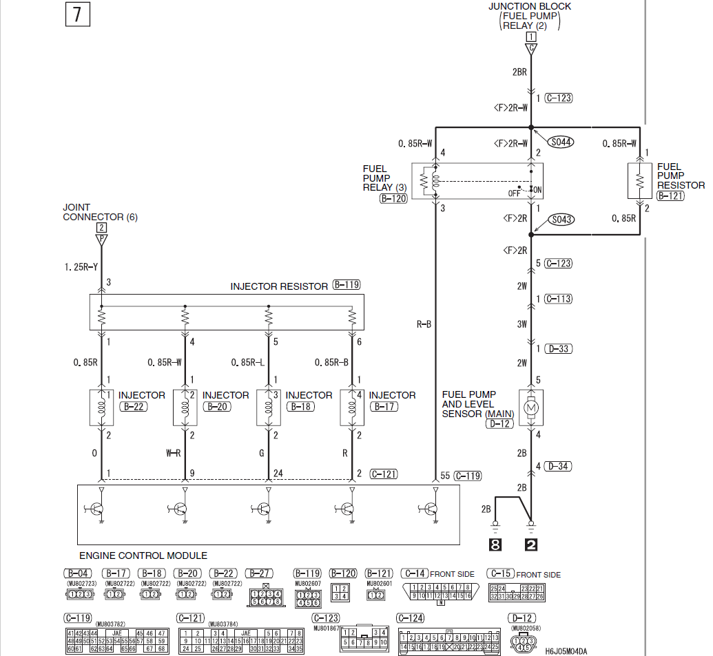

In other circuit diagrams, it is indicated that the ETACS ECU is within the Junction Box.
Right. It plugs to the back of the Junction box. Schematic 1 was referenced by Mitsu over the phone, saying that the Fuel Relay 2 is part of that circuit as well.
At any rate, I was hoping that you'd actually draw on the lower diagram (or on the accompanying diagram #7 where relay #3 is shown) to show what you shorted out.
I hope I am giving you the info your after:
If not:
Ok. I might sound like an idiot. Honest questions here. You just want an hand drawn sketch? Should I take a picture of the fuse panel, with my tester inline, and point to the leads I shorted?
I have been only referencing schematic 2 that I have been working from. So I have only known to reference those points on the schematic. I get all my info from there.
I am pretty sure it was lead 3 to lead 4 I shorted. However, I thought during actual test I was testing lead 3 to lead 2. So I do not know exactly which of those leads I shorted to lead 4.
But I do know, it was on Relay 2.

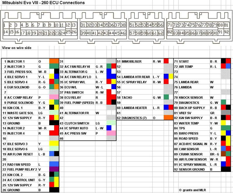

Bump for post 31. Also is this the correct pinout for the EVO 8? If it is, since their is no signal or voltage at relay 3, I am assuming that Fuel Pump Relay 2 Pin 2, outputs to ECM/ECU Input Pin 22 which then runs through ECM to Pin 39 which outputs signal to Fuel Pump Relay 3?

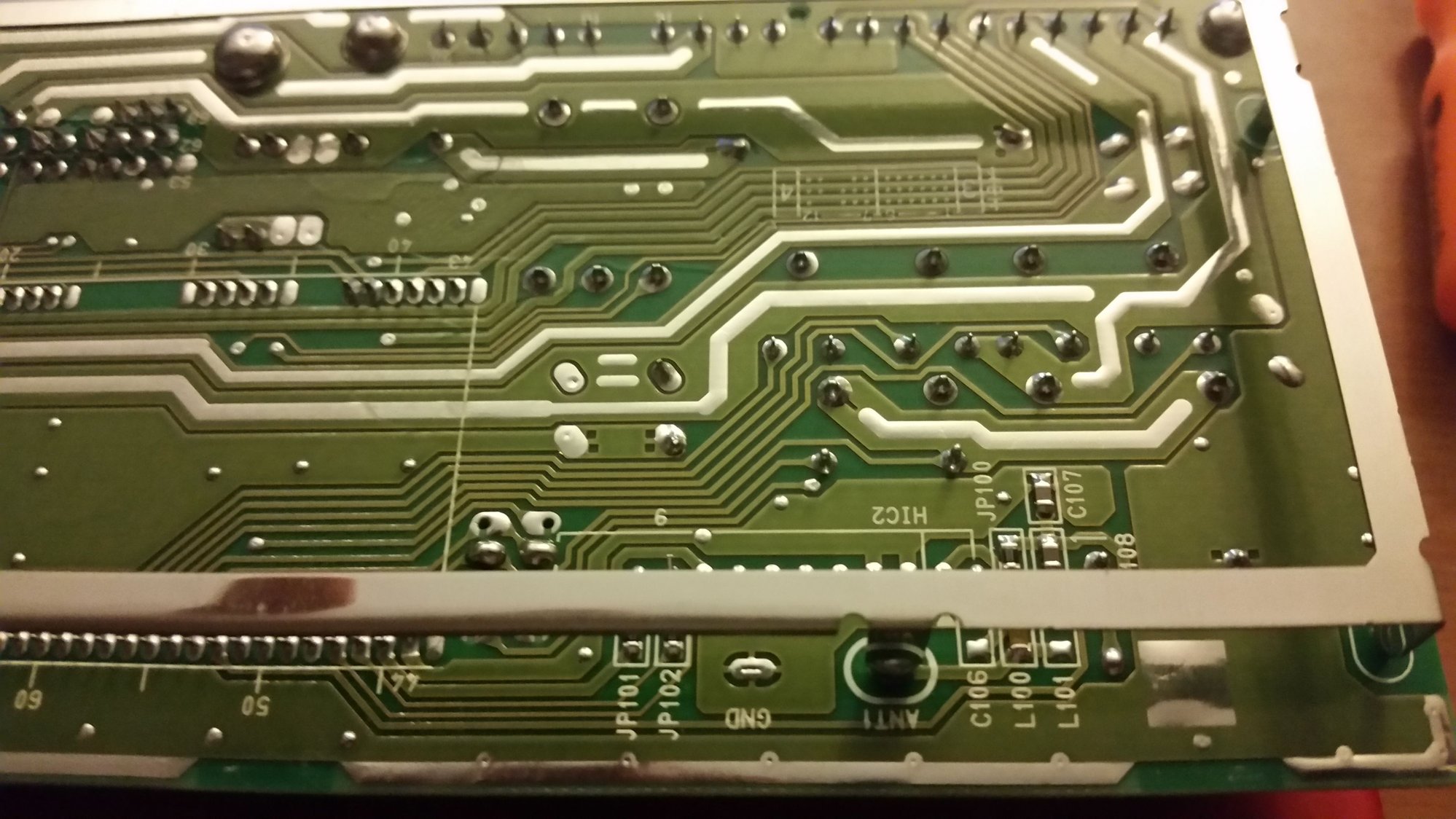

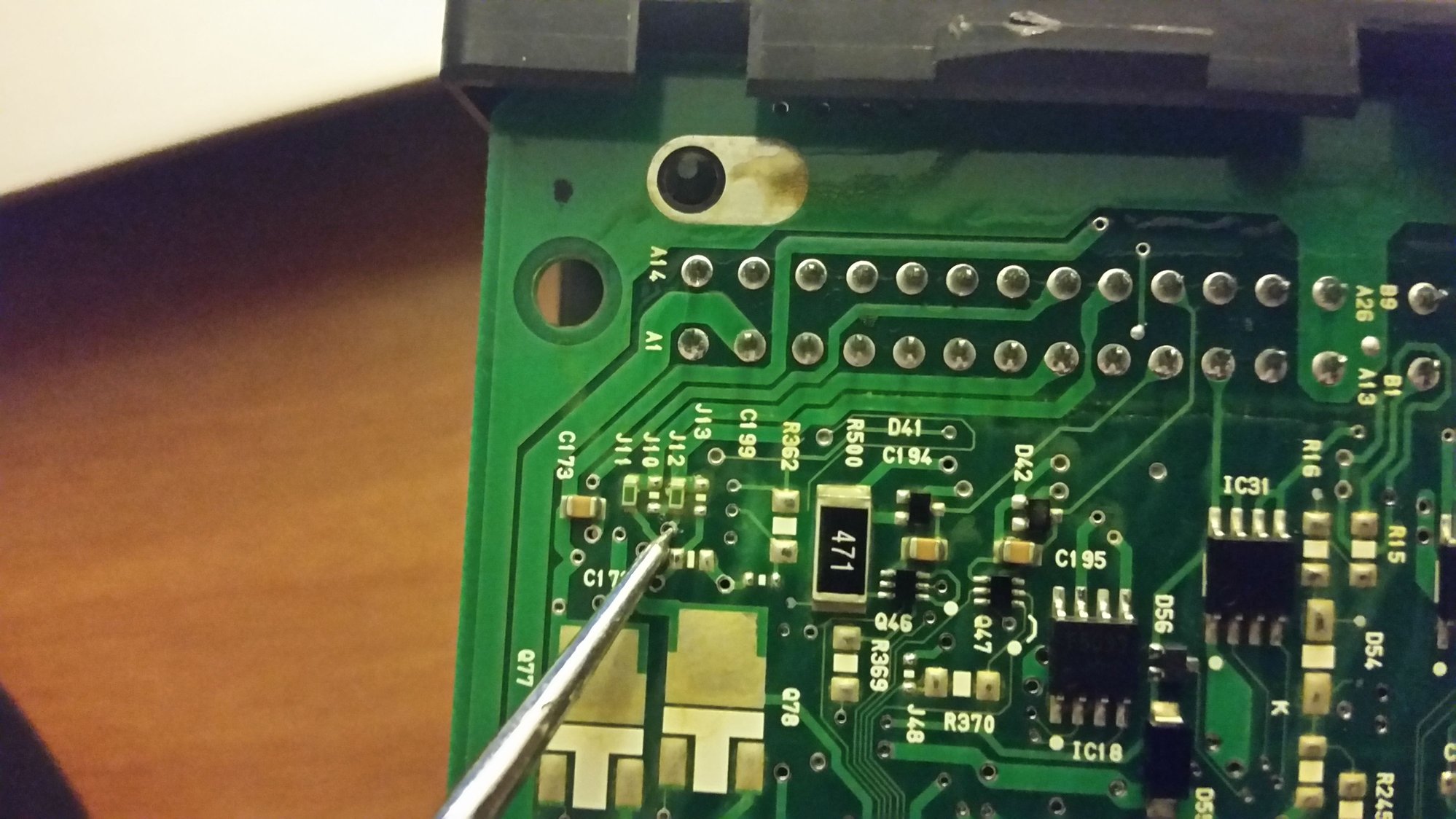

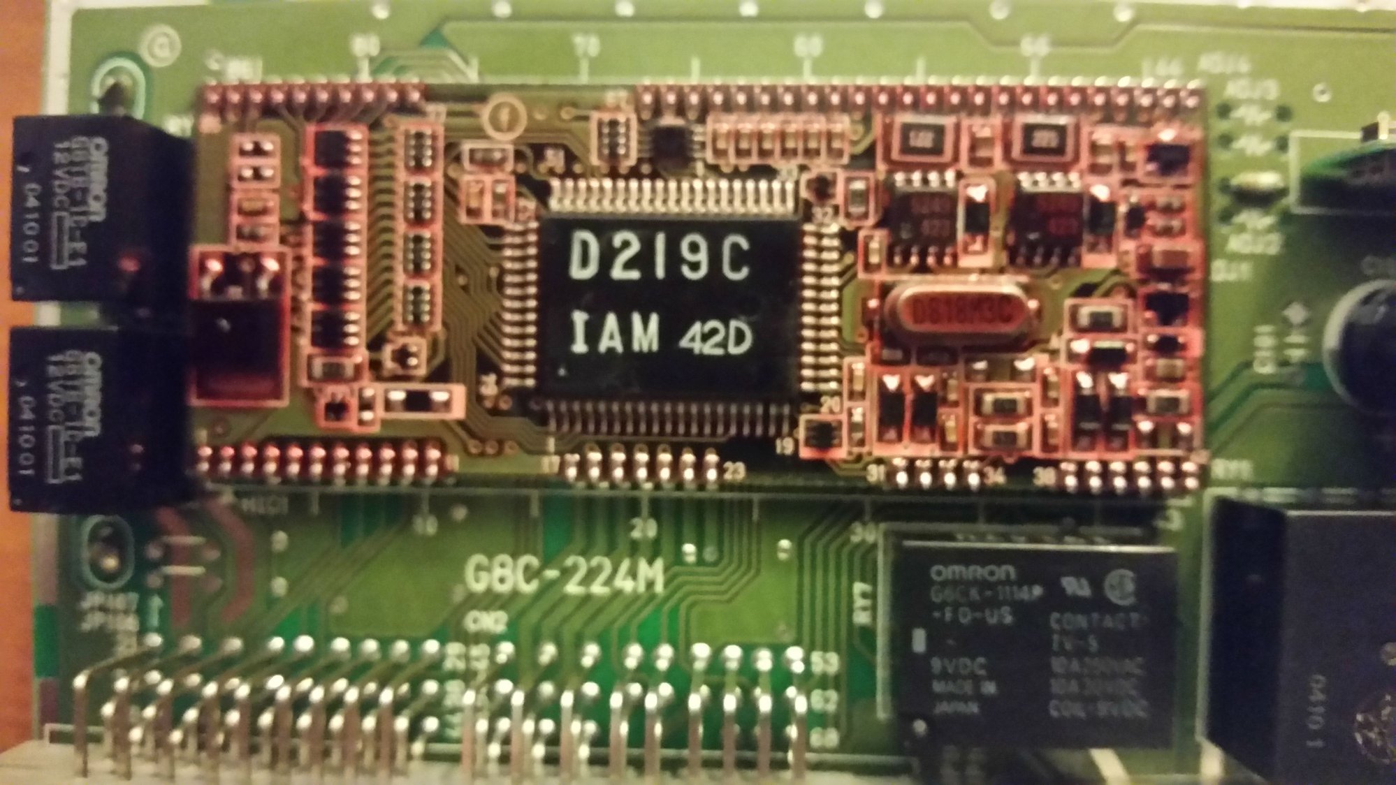

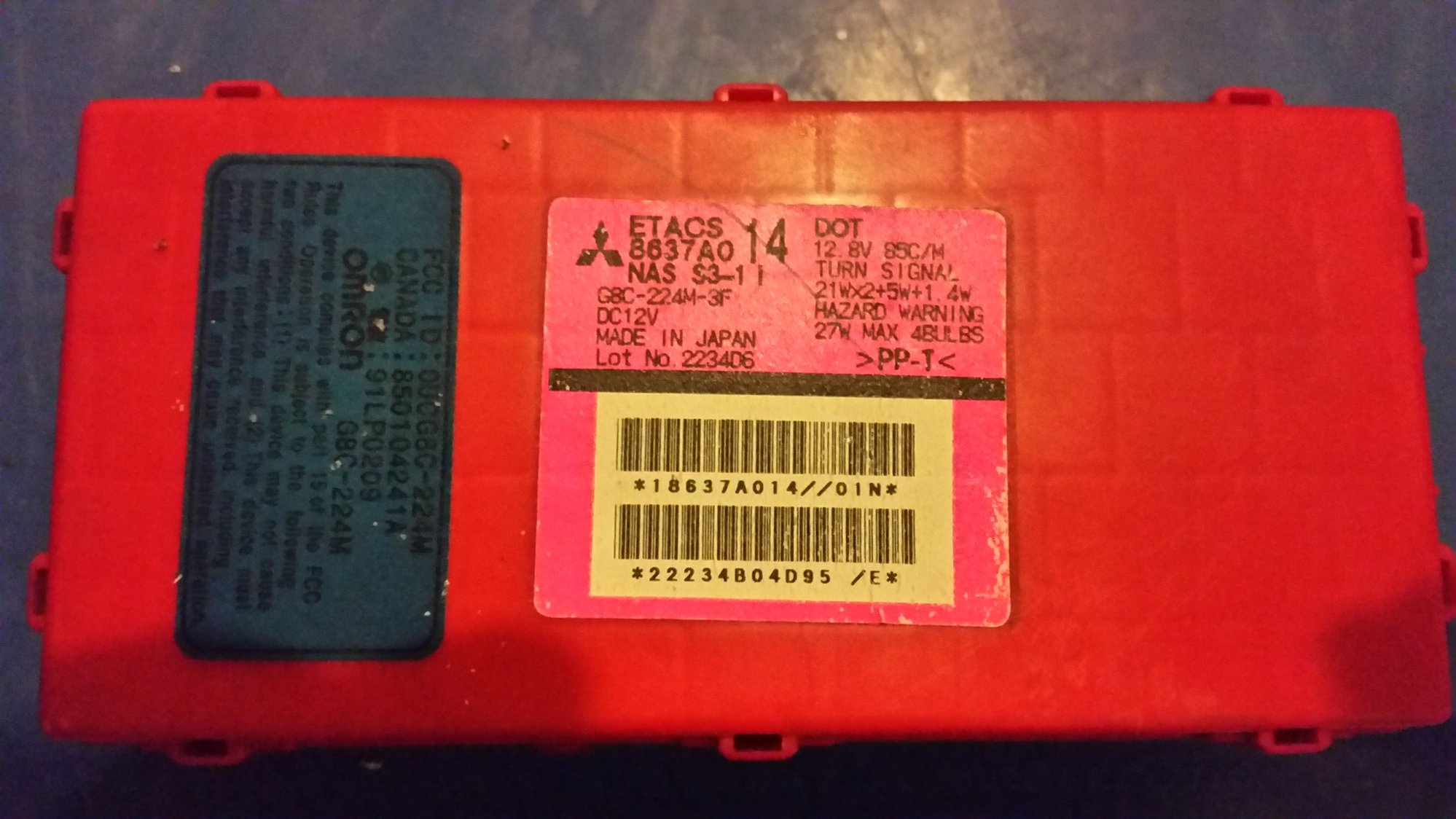

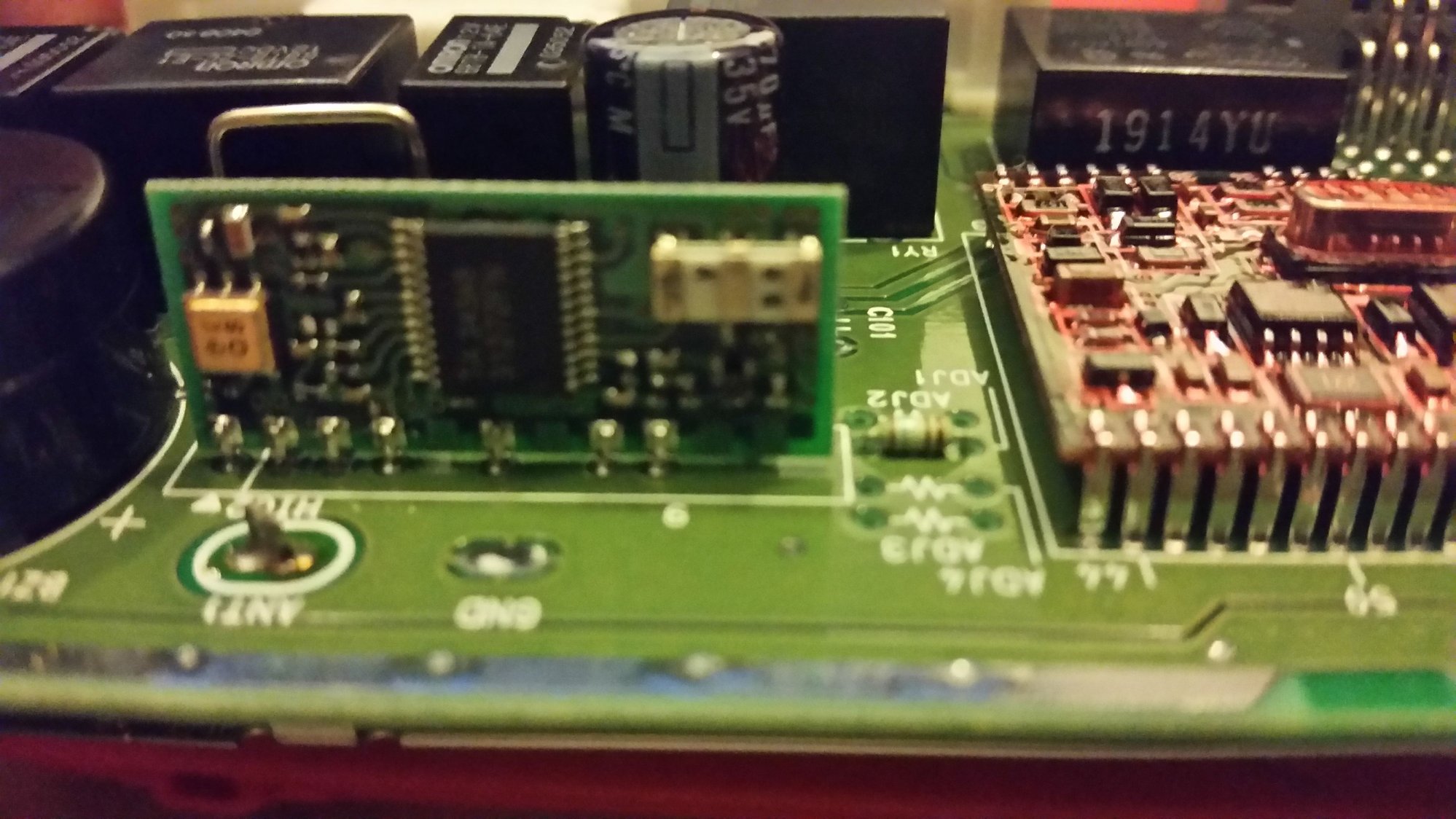

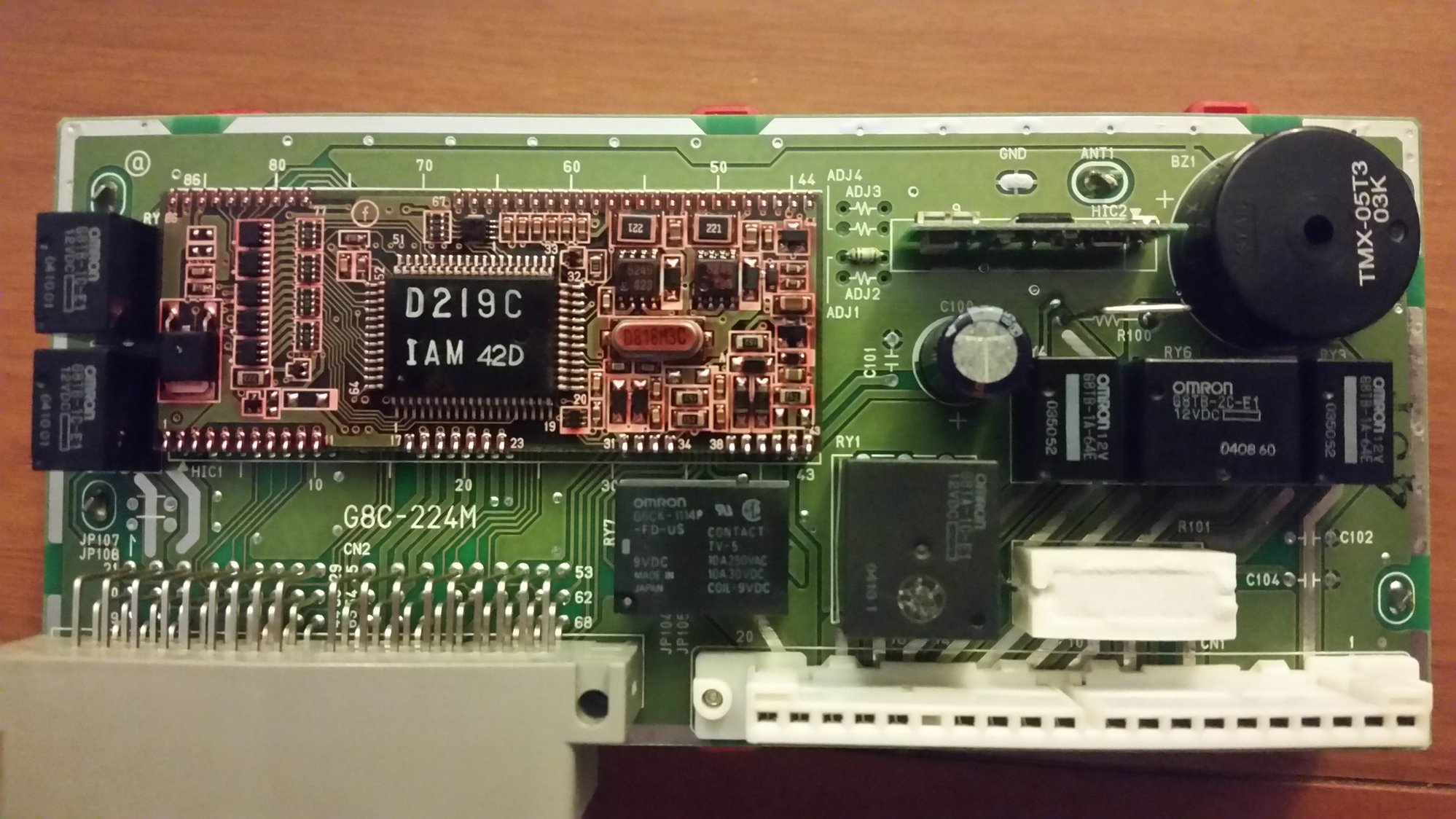

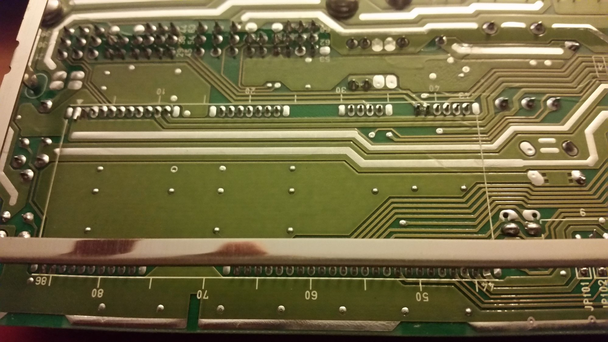

As suggested by Merlin and Tephra, I have pulled both the ETACS ECU and the ECM, and pulled both apart to have a visual inspection. To my surprise both ECU's look in very excellent condition. Here are the pics of both units.
I also tested Pin 22 of the ECU based on post 33 pinout arrangement. Also someone suggested this is the pin or circuit with the ECM I may have fried. Stated there was a transistor attached to this pin that might of taken the brunt. So I decided to do a continuity test through the circuit as far as I could.
I traced Pin 22 through the ECU to Diode 1 we’ll say. Continuity tests good through diode 1. Tested to Transistor 1 we’ll say. I get full continuity from pin 22 to this transistor. I also can test both sides of the center of this transistor and get continuity. I get nothing on the other 2 leads of this transistor, I am assuming due to no power. I kept going anyways through the circuit testing continuity. It ends at the main chip from what I can tell after several diodes, and a couple other transistors. I lose the circuit after that. Just for comparison, I tested other circuits on the board, and get the same results on all transistors and diodes.
I guess what I am saying is, that it looks like the first transistor in the circuit is intact. No melt parts, no burn marks, no shorts. I would think that if I fried this circuit, this transistor would have taken the brunt and burned. It doesn’t appear to be damaged, and if the center lead tests good to both sides of the physical transistor, then I would assume it works…
I have been looking just in case the worse, and all replacements available are and have part number MRXXXX, I think I saw that they are compatible, but not sure yet.
Transistor 1 in circuit from pin 22. Test good, center pin to back center lead.
Diode 1(I think it's a diode) inline from pin 22. Test good. Both sides, continuity through.<br/><br/>You can count the leads, starting left to right on the bottom row, then move to the top row and count out to 22.

Sorry for not responding sooner. I was busy. Shorting pin 3 to pin 4 on relay #2 on that diagram would have done nothing, but shorting pin 3 to pin 2 would have fried the transistor relay in the ECU at pin 21 in that same diagram. I fried the transistor relay for mechanical relay #3 when I was doing my rewire, and there was no obvious damage either. I was able to have it repaired by the folks at DSMLink. I sent them a photo showing them what I wanted replaced (along with the ECU), and they successfully did the job. I've been running on the repaired ECU for several years now.

Thanks MRFred. But just for clarification, on the color coded pinout in post 33, I'm in a GSR, not an MR, so is it pin 21 or 22? THat pinout diagram I posted states pin 22. I'm just asking to clarify.

If you have an '04 Evo, then yes, its pin 22 on the ECU.

Both of you, I was able to start the car. Shorting pin 22 to ground, and it took a couple cranks after being dead for 3 weeks, but she started up, and never sounded so good. Yeah to both of you.
I would like to understand what I just did. If grounding pin 22 starts the car, then is it a wiring issue between Relay 2 and the Input on pin 22? Can someone explain how the circuit works?

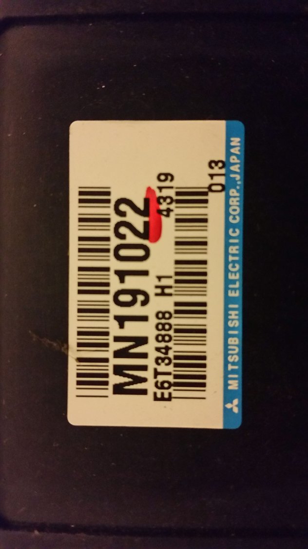

Can anyone tell me of any unknown issues with just swapping a like ecu for like ecu? Like if I wanted to maintain the immobilizer function. Do I need to find an ECU with immobilizer circuit and key as well? Or are ECM/ECU's from the same year, with same connections(4 in my case), able to just plug the immobilizer hex of my vehicle into the ROM I am using and flash, and we're good?
In the diagram in post #31, pin 21 (your pin 22) is shown with a transistor symbol with the emitter terminal to ground. The transistor acts as a switch between the pin and ground, so when the ECU turns that switch ON current will flow through the fuel pump relay coil to ground and therefore enable the fuel pump.
Shorting the relay coil (pins 2 & 3) connects the input to the transistor switch to the battery so when the ECU commands the switch ON, lots of current flows until the transistor burns out (which often happens before any fuse can blow).
Shorting pin 22 on your ECU to ground has the same effect the transistor would normally have when ON.
