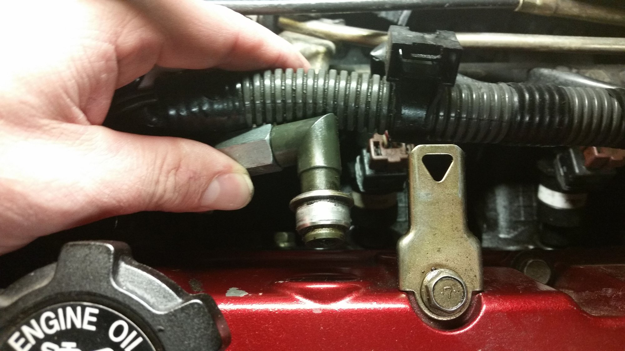

Found this little issue: Oil all over the backside of the motor, on the MAP sensor, Fuel Relays, Fuel Pressure Solenoid, etc. Took me a bit, but cleaned everything I could get to, and topped of the missing quart of oil. It was tough, but pushed the check valve back into place. Any suggestions on making sure it doesn't come out again? Side note, I have a breather valve on the other end of the valve cover going to a catch can. I still must have a lot of crankcase pressure to push the check valve out of the valve cover... Any thoughts?

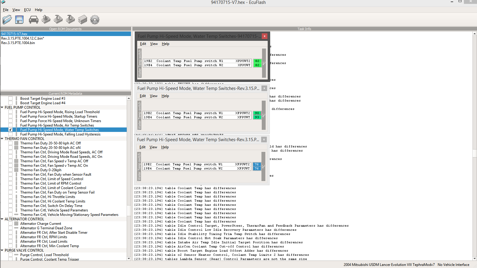

Went through my tune and found an anomaly. I didn't change this temperature when changing out my thermostat, and have a sneaky suspicion, that this is the culprit. "Fuel Pump Hi-Speed Mode, Water Temp Switches" I was playing around with these prior to my thermostat goin out, and never noticed. I assumed these tables were for overheating affect, to cool the motor. But after looking through the code, and finding that the stock ROM was set to the 82 degrees C just like all the other temp scaling, I assume it controls the fuel pump and allows it to go high pressure mode. Someone can correct me if I am wrong. Maybe some of the disassemblers can chime in and tell me what exactly these switches do. I know what the Rising Load threshold does, but all the other ones I have just guessed on. I remember MFRED saying the Load Hysteria needs to stay the same at 5.0. Either way, we will see here after while when I can start it. Neighbors get a little upset when I fire this thing up at 4 A.M. LOL.
Here is the 94170715 tables and defs:
<table name="Fuel Pump Hi-Speed Mode, Rising Load Threshold" category="FUEL PUMP CONTROL" address="4556" type="2D" scaling="Load8">
<table name="ENGINE" address="635a" type="Y Axis" elements="10" scaling="RPM"/>
</table>
<table name="Fuel Pump Force Hi-Speed Mode, Startup Timers" category="FUEL PUMP CONTROL" address="19d2" type="2D" scaling="FP_TIME">
<table name="Startup Conditions" type="Static Y Axis" elements="3">
<data>19D2 Force Hi-Speed mode After Startup, Water Temp exceeds W2 and Air Temp exceeds A2 XPUMPTM</data>
<data>19D4 Force Hi-Speed mode After Startup, Water Temp exceeds W1 and Air Temp exceeds A1 XPUMPTM2</data>
<data>19D6 Force Hi-Speed mode After Startup, Water Temp below W1 XPUMPTM3</data>
</table>
</table>
<table name="Fuel Pump Force Hi-Speed Mode, Unknown Timers" category="FUEL PUMP CONTROL" address="19d8" type="2D" scaling="FP_TIME">
<data>19D8 Force Hi-Speed mode, Water Temp exceeds W2 and Air Temp exceeds A2 XFPUTM</data>
<data>19DA Force Hi-Speed mode, Water Temp exceeds W1 and Air Temp exceeds A1 XFPUTM2</data>
<data>19DC Force Hi-Speed mode, Water Temp below W1 XFPUTM3</data>
</table>
</table>
<table name="Fuel Pump Hi-Speed Mode, Air Temp Switches" category="FUEL PUMP CONTROL" address="19de" type="2D" scaling="Temp16">
<table name="Air Temp switch" type="Static Y Axis" elements="2">
<data>19DE Air Temp Fuel Pump switch A1 XFPUAT2</data>
<data>19E0 Air Temp Fuel Pump switch A2 XFPUAT</data>
</table>
</table>
<table name="Fuel Pump Hi-Speed Mode, Water Temp Switches" category="FUEL PUMP CONTROL" address="19e2" type="2D" scaling="Temp16">
<table name="Water Temp switch" type="Static Y Axis" elements="2">
<data>19E2 Coolant Temp Fuel Pump switch W1 XFPUWT2</data>
<data>19E4 Coolant Temp Fuel Pump switch W2 XFPUWT</data>
</table>
</table>
<table name="Fuel Pump Hi-Speed Mode, Falling Load Hysteresis" category="FUEL PUMP CONTROL" address="1a74" type="2D" scaling="Load16">
<table name="Load" type="Static Y Axis" elements="1">
<data>1A74 FP Hi-Speed mode, Load Hysteresis XPUMPAN</data>
</table>
</table>
The top table is the stock rom, the middle table is where I had it set prior to the thermostat failure, because my car ran hotter than normal, 3rd table is what I have it set to now, since my hot temp in all my scalings is the 76 Degrees C.

I fixed the check valve connection to the valve cover, good to go, held on for a brief test tonight in boost, that ended up way lean.

Originally Posted by Raceghost
My FPR says 43.5 with the procedure I just listed, when I connect vacuum, it drops to 39~40 PSI on the gauge, at the rail. Does someone care to comment?
Have you tried adjusting your AFPR to ~33psi with vacuum? Will it let you? If not, then I would look towards a restriction in the return (usually at the fuel pump assembly).
If I interpret right, your saying drop the AEMFPR down at idle to 33 psi, then pull the vacuum line and see how high it jumps?
Yes, see if you can adjust the fuel pressure down to 33psi, and what it is after you pull the vac line.
