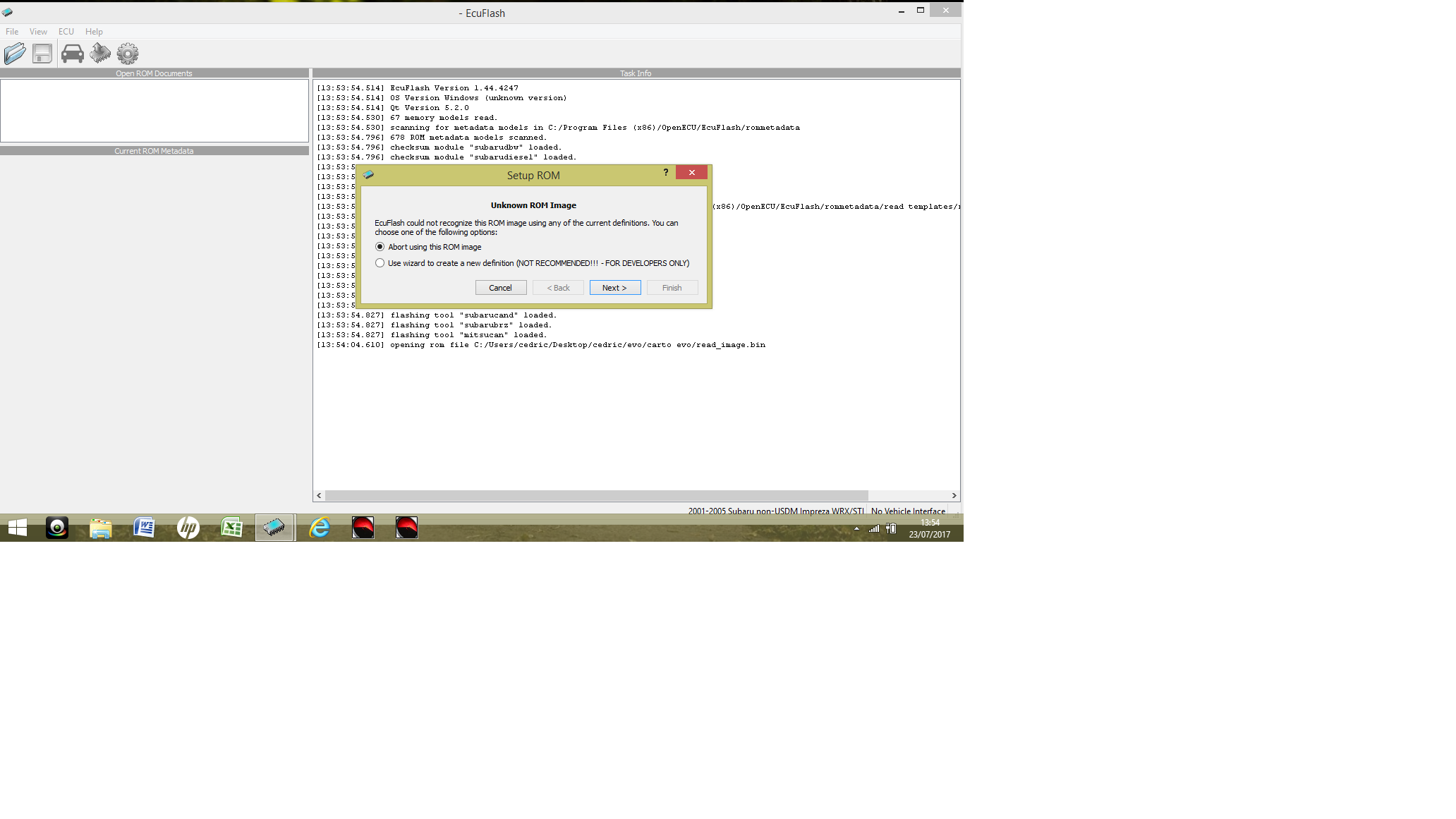

I have always this message

It looks like a modified version of 88840017 - for the 2006 EDM Lancer Evolution MT.
I stripped off the file header and then reset the ROM ID at F52 to 88840017.
Try this modified version of the file which is readable in ECUFlash.

Your 88840017.bin rom is ok in my ecuflash.......i can read it
you have only reset the rom ID of my rom ?
thanks a lot

Yes I have only reset the ROM ID which is at address 0F52 in the file. The ROM looks like it is from the 8884 family which was installed in the 2006 European market Evos, but I cannot guarantee it is correct. I made an educated guess so beware.
