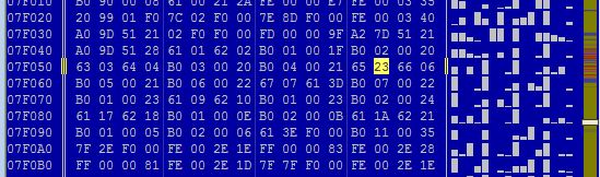

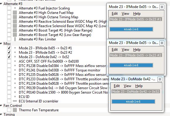

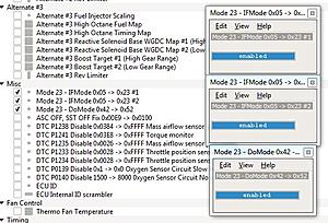

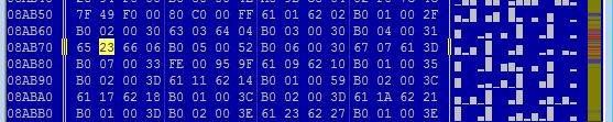

Old Feb 5, 2018 | 12:46 PM
GeoMitsu's Avatar
Joined: Oct 2013
Posts: 97
From: Lebanon
Please check the attached photos and give give me your opinions.
As for the evoscan I had the same doubts, so I uninstalled it deleted the linked folders and the reinstall it but with the same result.
I didn't try to uninstall the tactrix drivers or update them, I will try this and see the result.
P.S: I had the same issue with 53050012 and the tephra V3 53050312
Thanks
Attached Thumbnails 53050012 Logging-capture1.jpg   53050012 Logging-capture.-7f05d.jpg   53050012 Logging-capture-8ab71.jpg   53050012 Logging-capture-8ab76.jpg

Try logging to OP2 SDcard using logcfg.txt config or another laptop with evoscan?
