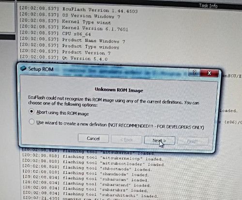

Hello,
new here and newbie to ecuflash; i'm just trying to help a friend hope you understand
So,
he's trying to open a rom given by another guy but ecuflash says "Unknow ROM image" etc etc.
As I understood it works with definitions, xml files, and I guess he doesn't have the right one.
This is the ROM infos:
He has a lot of xlm's file but anything with 88627779 ID.
He is sure that is a tephra modded rom but i can't find anything searching online for that ID.
No google results, no forums results, downloaded tephra rom definitions on his website, also from here but no file with that id.
Any clue?
may I try forcing others tephra/default xml? (is it even possible?) because i tried to modify a couple of xml, but then ecuflash crash.
He already tuned some evo 8's and 9 but always from stock rom; first time he got stuck.
any other infos that you guys need?
Thanks

If it's a pretuned ROM, the ID was probably changed to prevent tampering.
You can try changing the rom id to the Tephra V7 IX rom ID number and see if it breaks down. That's how I solved mine.

So you suggest to try all the tephra xml i found and manually change the ID? (or change the rom ID with and hex editor....is it at 0xF52 always?
any other alterations that could be done? for example switching whole map parts inside the file and then manually fix the adresses in the xml file? or it will end to an useless file or bricked ecu if trying to flash it?

I didn't need to change the ID in the actual hex file. I just needed to change it on ecuflash's side. I cannot remember specifically where I did it.
Most of the info on the forums do have you change it in a hex editor. Most of the time, I do believe its in 0xF52.
I will try and update when I get to my tuning computer.

I modified the rom ID using an hex editor at address 0xFCA trying all the tephra ID i have and only one is kind of working.
The file loaded from ecuflash is the genuine "TephraMOD-88590715-v7.xml" and of course is the one for evo IX.
BUT if i open some tables they don't make any sense.
Values on axis and inside cells are totally wrong.
I think the adresses are wrong.
So, others alterations are mode for sure i guess.....what could it be?
thank you

Good Morning Guys,
I think I made it
Yesterday I tried only EDM-USDM roms because the file is from an European market car so......why try totally different files?
Well, it seems to be replaced with an AUDM rom.......why :|
By the way ecuflash now loads the rom correctly and all the tables, axis values, cells values etc are good
So thank you Project.
Last thing,
when the rom is loaded I got this in the log window:
[10:53:44.280] using metadata XML ID 88580714 from file C:/Program Files (x86)/OpenECU/EcuFlash/rommetadata/mitsubishi/evo/TephraMOD-88580714-v7.xml
which inherits XML ID 88580014 from file C:/Program Files (x86)/OpenECU/EcuFlash/rommetadata/mitsubishi/evo/ecuflash/branches/r3compile/88580014.xml
which inherits XML ID 88580013 from file C:/Program Files (x86)/OpenECU/EcuFlash/rommetadata/mitsubishi/evo/ecuflash/branches/r3compile/88580013.xml
which inherits XML ID evo9base_20081101 from file C:/Program Files (x86)/OpenECU/EcuFlash/rommetadata/mitsubishi/evo/ecuflash/branches/r3compile/evo9base_20081101.xml
what does it mean exactly?
Does it kind of load multiple definitions from different file?
And which is the safest way to manage the file?
Changing the rom ID in the ROM file? or keep it as saved from the ecu and modify the xml instead?

It's just inheriting from several ROM IDs, as long as the tables display correctly, and you can flash. It's completely fine.
