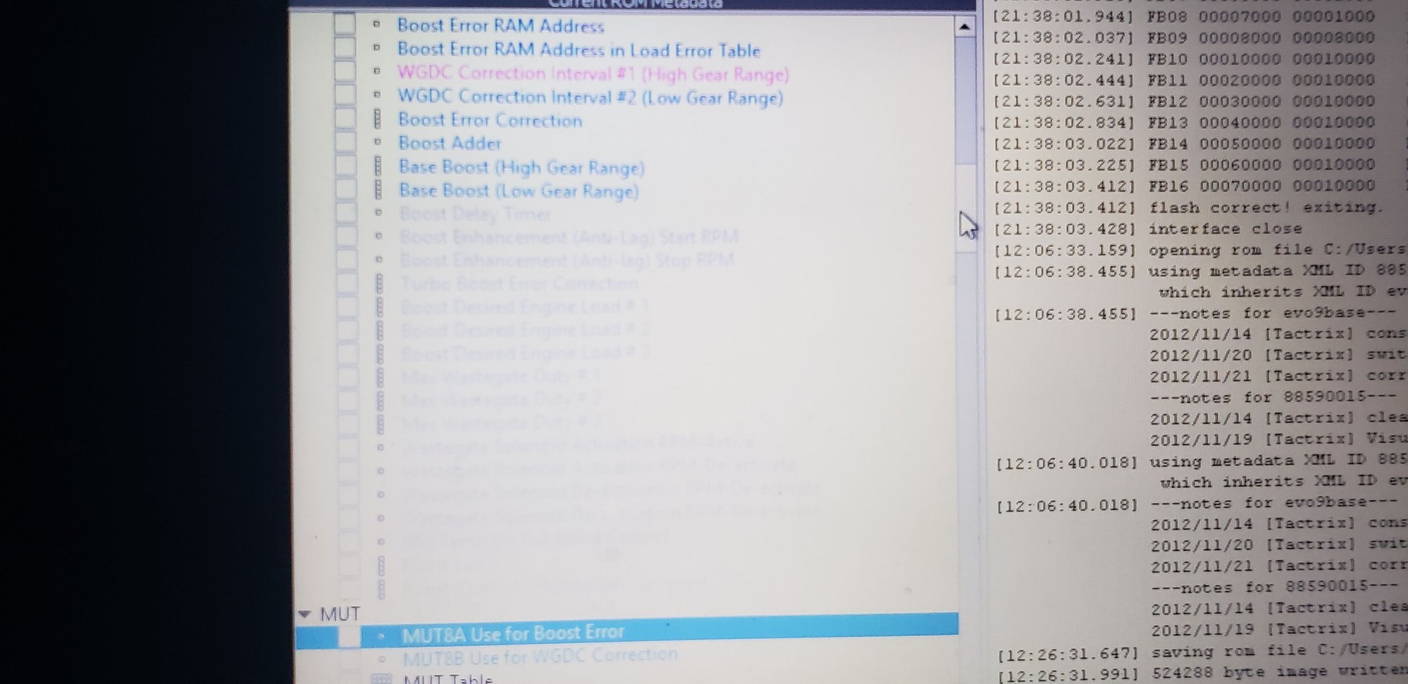

Back with more issues. I was going to install my 3 port solenoid and start tuning for boost but the tables I need dont work. It says the current map description is invalid or incomplete. Any ideas on how to fix this? I am in developer mode as well. All the light grey is what I need to work.

Come on guys, you can just say it. Hey you idiot, just scroll down further and all those new tables you added will show! Continuing on now... dont mind me. Going to see if I can blow this thing up tonight with some more boost!
