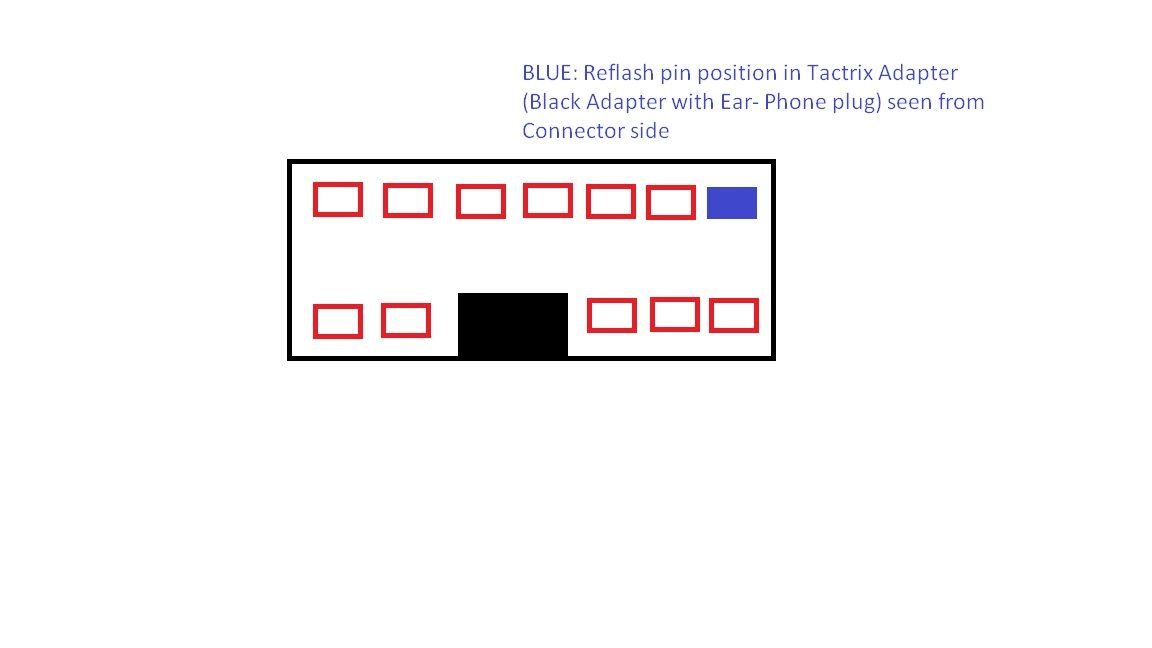

Try the following procedure:
Start the engine, let it run for about 5 seconds before pressing the read Button and the OK Button. The engine should be switched of by itself then and the read starts. IF that doesnt work, check that the Read Write Pin in the white connector ( Car Harness side ) is in the right position. Some Tuners changing the pin position for Read write inhibit, but Logging is working this way. ( matching the position of the female pin in the Reflash Tactrix adapter )
Do you have a diagram of the pin positions? By just taking a look at it, it looks like it's never been altered.

Heres the Pinout of the Tactrix 2.0 Reflash adapter
