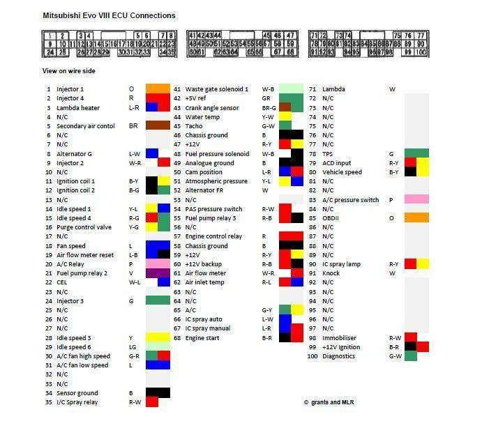

Hey - I ended up finding a cheap JDM e8 Ecu that I'm going to put into my 6. I've been trying to match up the pins and everything seems to be ok except for the diagnostic pins from the 6. The 6 has 3 "Diagnostic" pins:
  1. 56 - Dignostics (1)
  2. 62 - Diagnostics (7)
  3. 79 - Diagnostics
The e8 ECU only has:
  1. 100 - Diagnostics
  2. 85 - OBDII
What do I plug in where? I'm confused as to what I need to do. Any info helps
Thanks

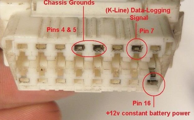

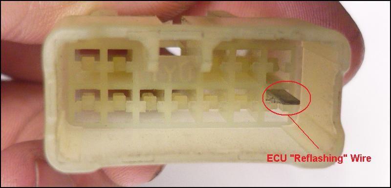

100 is the reflashing pin going to the OBD 1 port pin 26
85 is the diagnostic pin going to the OBD2 port pin 7
** thanks to the guys who shared these photos**

Thanks for the pics - that helps a lot. Once I get the ECU installed I'll put together a how-to and pinout for future reference
