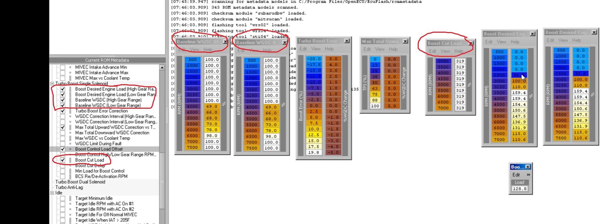

I bought an evo 7 that has a 21psi Turbosmart activator fitted as well as a grimspeed 3 port boost controller. I was told it was running wastegate boost 21psi, but had no boost guage. Fitted a boost gauge and realised it's running 1.8 bar. Pulled the airbox out and found the grimspeed ebc I wasn't aware was on the car.
I have a second motor that I am building and I just want this motor to last as long as it can. So I want to turn the boost down as low as it can go.
Wasted 10 minutes trying to find the manual valve to turn down the boost on the grimspeed before googled it and realised it has to be done through the ecu haha.
Went and purchsed a tactrix openport 2.0 and found a pretty informative youtube video on how to tune electronic boost solendoid from ECUflash. I've attached a screen shot showing the tables it tells me I need to change to lower the boost. But in my copy of ECU flash I don't have the options I've circled in red.
How do I add these tables so I can lower my boost?

You need to post your rom and xml to see what you have. What rom ID, who's xml definition are you using etc. If you just want to run waste gate pressure then just take off the hoses, easy. If you want to go naturally aspirated, take off the actuator arm.
