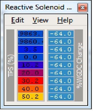

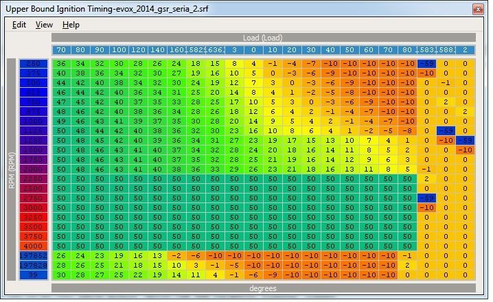

I have a probleme with correct displaying scales/datas for some maps in my ROM 50845084. Problem exists on definition from ECUflash (ver. 1.44 and also 1.42) as well as on the definition taken from the internet.
Below an example of what I'm talking about:
Wrong RPM and Load scale
"Reactive Solenoid Max Total Upward WGDC Correction vs TPS" - wrong TPS and WGDC values
I am concerned that making any changes to these maps will not block the ECU or improperly work of engine.
Also, because of this, I'm not sure if other maps are displayed correctly.
Could you please advise me where is the problem and if I can use my existing definition ?
Thank you in advance for your comments.

Correct addresses seem to be like below(use it at your own risk.):
<tablename="Upper Bound Ignition Timing"address="60c0d">
<tablename="Load"address="61826"/>
<tablename="RPM"address="617f2"/>
</table>
<tablename="Lower Bound Ignition Timing"address="507b0">
<tablename="Load"address="61cf2"/>
<tablename="RPM"address="61c70"/>
</table>
<tablename="Reactive Solenoid Max Total Upward WGDC Correction vs TPS"address="58d22">
<tablename="TPS"address="62ff6"/>
</table>
