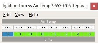

Hi all,
I just wanted to know if anyone has the scaling parameters to change fahrenheit to celius for the 96530706 V7 xml
This would make it easier for Evo owners worldwide who own JDM / EDM / AUDM cars who use this xml who use this scale of temperature for different tables in ECUFLASH.
Currently they are listed as:
<scaling name="Temp" units="Fahrenheit" toexpr="(9/5)*(x-40)+32" frexpr="(5/9)*(x-32)+40" format="%.0f" min="-30" max="900" inc="1" storagetype="uint16" endian="big"/>
<scaling name="Temp8" units="Fahrenheit" toexpr="(9/5)*(x-40)+32" frexpr="(5/9)*(x-32)+40" format="%.0f" min="-30" max="900" inc="1" storagetype="uint8" endian="big"/>
<scaling name="TempScale" units="Fahrenheit" toexpr="(9/5)*x+32" frexpr="(5/9)*(x-32)" format="%.0f" min="-30" max="900" inc="1" storagetype="int8" endian="big"/>
<scaling name="TempScaleFuel" units="Fahrenheit" toexpr="(9/5)*(x/10)+32" frexpr="(5/9)*(x-32)*10" format="%.0f" min="-30" max="900" inc="1" storagetype="int16" endian="big"/>
Would anything else apart from the scaling for these need to be changed to view the rom in celcius?
Anthony
Anthony
try these:
<scaling name="TEMP" units="*degCelsius" toexpr="x-40" frexpr="x+40" format="%.0f" min="-40" max="140" inc="1" storagetype="uint16" endian="big"/>
<scaling name="Temp8" units="*degCelsius" toexpr="x-40" frexpr="x+40" format="%.0f" min="-40" max="140" inc="1" storagetype="uint8" endian="big"/>
<scaling name="Temp16" units="*degCelsius" toexpr="x-40" frexpr="x+40" format="%.0f" min="-40" max="140" inc="1" storagetype="uint16" endian="big"/>
<scaling name="TempScale" units="*degCelsius" toexpr="x" frexpr="x" format="%.0f" min="-40" max="140" inc="1" storagetype="int8" endian="big"/>
<scaling name="TempScaleFuel" units="*degCelsius" toexpr="x/10" frexpr="x*10" format="%.0f" min="-40" max="140" inc="1" storagetype="int16" endian="big"/>
