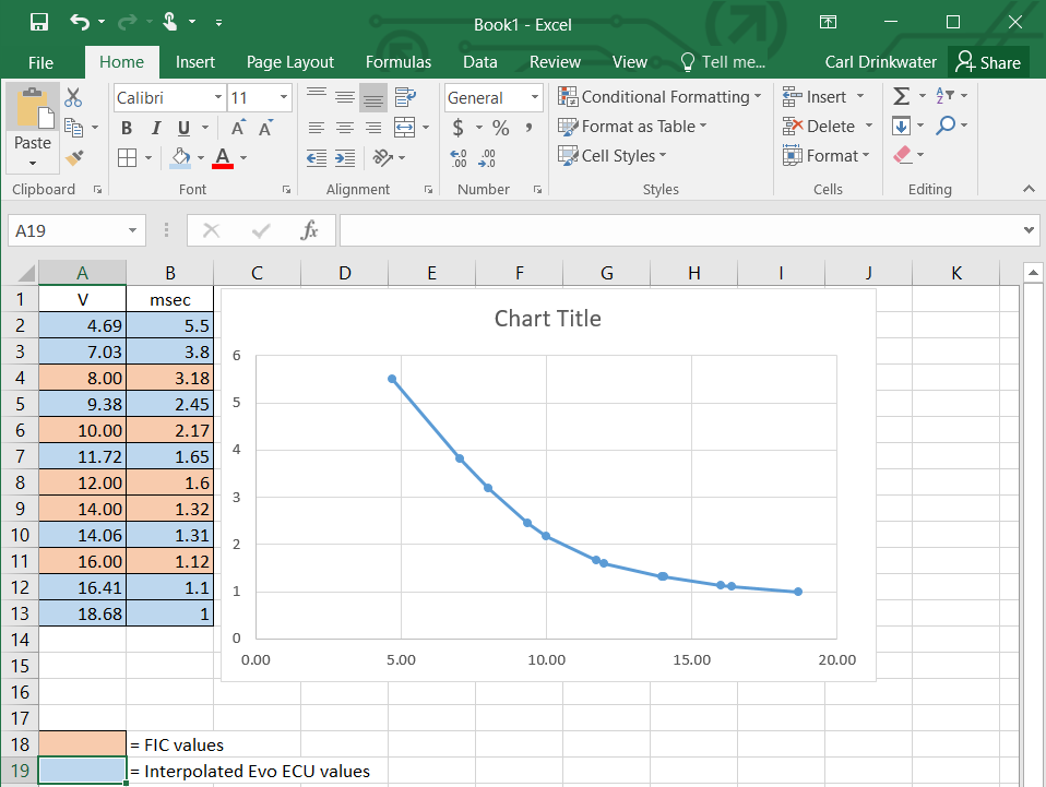

Does anyone have the proper 93 scaling for fic 1220cc injectors as well as the battery data? The provided data sheet does not match all the defined values.

You can use Excel like this to estimate the Evo ECU values so they fit the shape of the curve.
