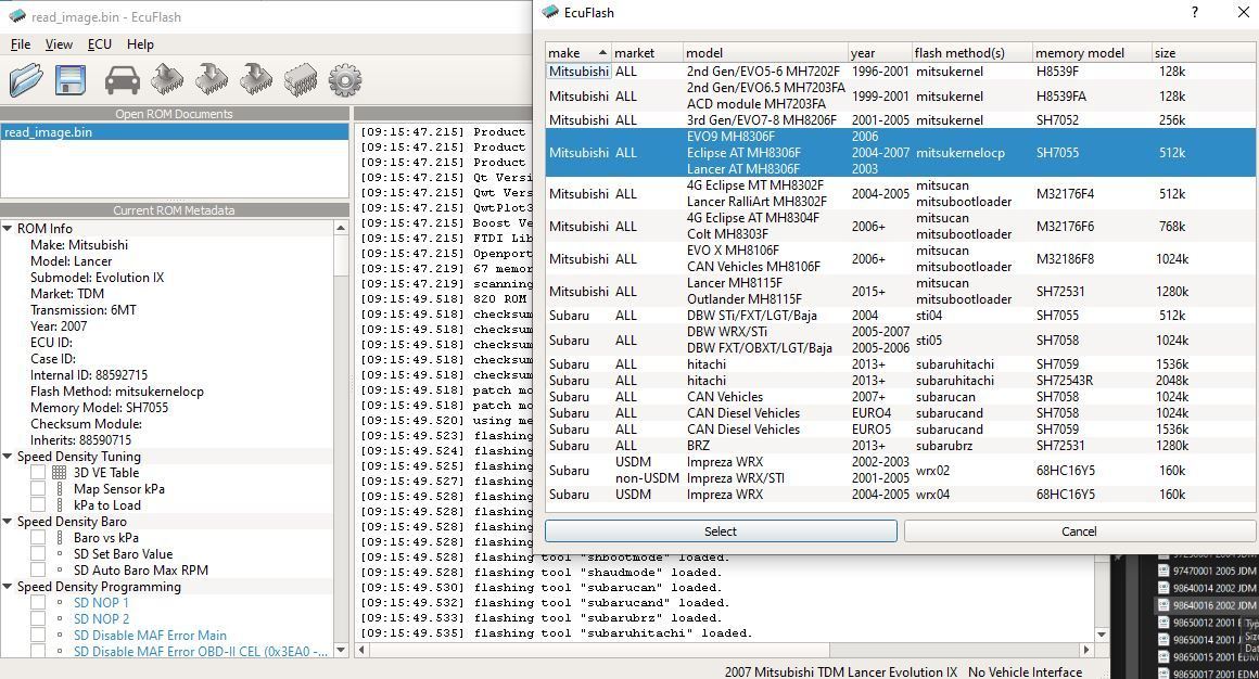

Here is some shots of what you were asking for.

hmmm weird. It's definitely not locked, and I can read it. I can upload a zip of my evo metadata folder if you want it.

That would be great. I feel like ill try anything at this point.

Hopefully this works for you

Thank you very much, I don't know what the difference is but it is working.
