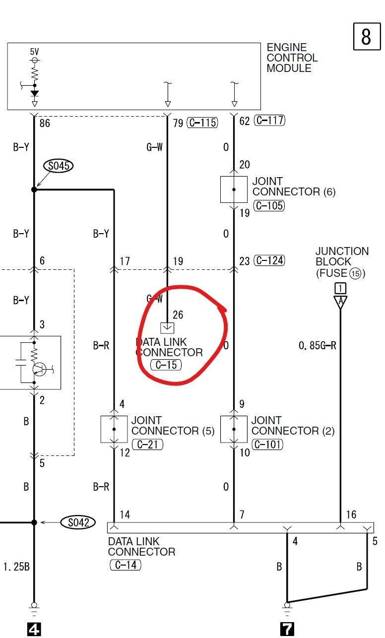

@Turtletron You must have +12.4V from the Openport 2 mini jack to the white flash connector and key on, ignition on, to be able to read or write. That white flash connector plug (pin 26 C-15 circled in red) supplies +12V to pin 79 (Evo 8), pin 100 (Evo9) on the ECU which is required to run the boot initiation code for ISO 9141-2 K-Line serial communications on pin 62 (Evo 8), pin 85 (Evo 9).
Evo 8 Wiring Diagram:
Evo 9 Wiring Diagram:

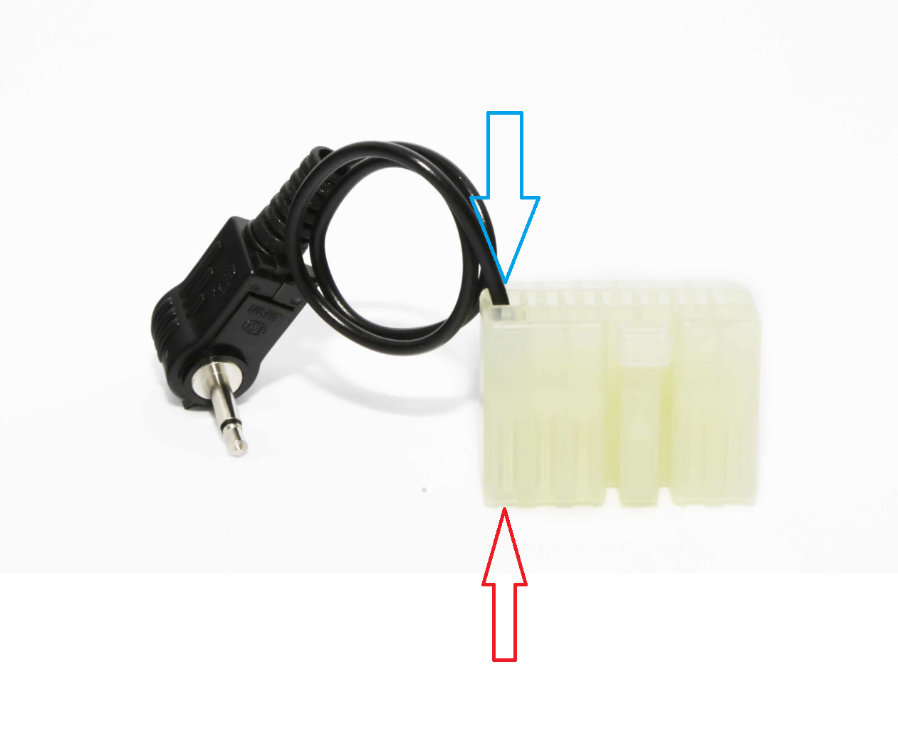

You would want to test for voltage with your probe at the connector, if it's plugged in you can back probe it (blue) or if not plugged in you can probe it from the front (red).
