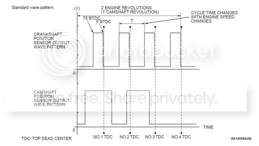

I'm a newb, but in my search to solve the CEL when running the USDM rom on a 1G DSM with the EVO 8 ecu...I found that there's two different cam reluctor wheels. One for USDM and another for the EDM/JDM/etc. There are two technical manuals for the Evo 8, and the waveform patterns of the cam reluctor are different. Not different enough to keep a USDM car from running on the EDM rom...but different enough to cause issues IMO.

Well, the EDM rom that I hear used most is the 9653, like you're running. I'd assume the JDM cam reluctor wheel is the same as the EDM one, but I've never seen one. USDM stuff is probably the odd man out due to the emissions laws and such.
The USDM cam reluctor wheel has a waveform like this. Keep in mind that you're looking at the low portion of the wave, not the high (the diagram is also mislabeled, the firing order is 1-3-4-2 like always):

They're close enough to be interchangeable, but the USDM one has a very small cyl #4 TDC trigger, whereas the EDM one is almost identical to the 2G DSM/3G Eclipse pattern. One long tooth and one medium tooth. I can see how an EDM rom might have some small hiccups when dealing with the shorter #4 tooth, when it's expecting a longer one that starts earlier in the cycle. That could be causing some phantom driveability issues IMO.
