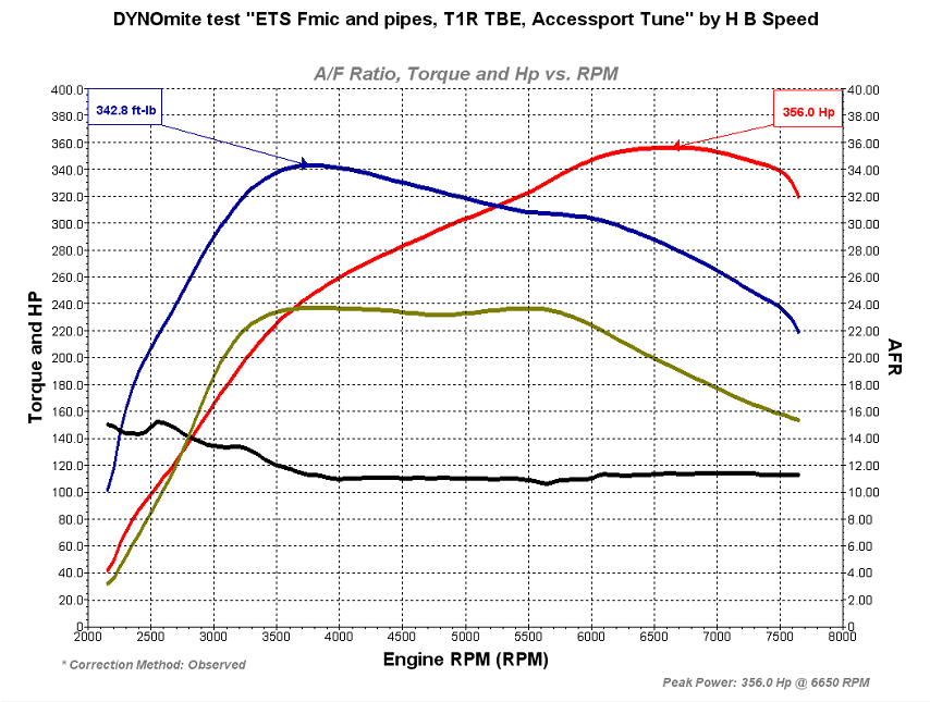

356 whp 91 pumpgas Evo X
Car has:
-T1R turbo back exhaust w/downpipe and testpipe
-ETS 4" black fmic with upper and lower ic piping
-ETS intake
-HKS ROFLBOV
-Forge actuator
-Cobb Accessport PROTuned
-0 Correction = Observed (70 is today in the dyno area)

Nice!
Is that green line boost taper?

yea
im gonna do a PILL and see what happens on this sucker
ive got a few more to test so i hope to make more power soon!

curious to see your results once your take your pill...what did the boost start/taper too?
