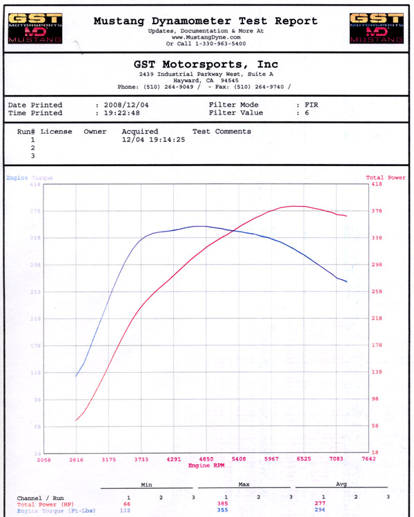

Update-
I got the valvesprings out of the car only to discover that they looked like this:
Changes since the initial post are:
Sparktech Non CDI COP and FP Beehive valvesprings. The cams, injectors, fuel is still all the same. Here is the power-

Originally Posted by jid2
^^^^Are those out of your car Aaron? So what springs were those, stock?
Yeah those were out of my car. If you look at the first dyno graph its cropped past 6900. In the next 200rpm it lost 70whp so I wasnt going to talk about it until I knew for a fact I had a broken spring or severe valvefloat. Either way I knew they needed to come out.
Brief story-
Stock valvesprings went 1.5 seasons of dragracing and hard street driving (jan 06-aug 07) with a normal trap rpm of 8300. This is when I had the 6 speed in the car. They saw 8700 on 3 seperate occasions and went 28k with no issues.
These springs I will for now call Brand X, went 12k (season or less) with the same driving style. The same normal trap rpm, 2 or 3 trips to 8500+ and then when I took it to the dyno and it was obvious something wasnt right.
Now its on FPs and I will never go back (unless I need more rpm at some point).
