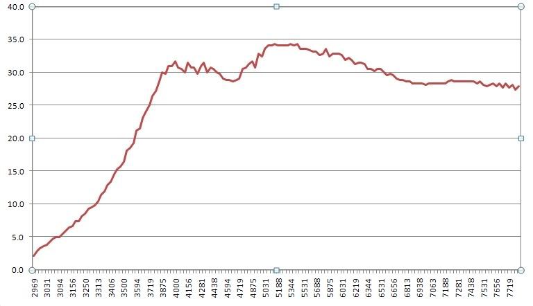

After looking over the logs very carefully... my target boost was 32.3 psi. Had I set the target @ 40+.... I wouldn't have been pulling WGDC... and my torque would've been RETARDED. I still have a lot of tuning to do on the race gas setup haha.

What WGA and bosot control are you using? That is a funky curve. Are you saying that curve is because you where hitting error correction?

Yes,
The funky boost curve was from the error correction. The Boost Adder got the best of me. Obviously the boost controller isn't controlling boost, rather limiting...but then again I haven't spent any time tuning it.
GST... this was literally 7 pulls from my pump gas map to get this tune. I realize that's not the right way to do things, but like I said before... I'll be back with the Magnus hopefully next week for a long tuning session. My WGA and EBC setup are listed above.

A single 3rd gear pull will show the power it's making, but did you check the logs and tune when going through the gears? You could possibly be hitting different load cells.

Damn! Are you going with the WGA that came with the Red or the 25psi? I have a similar setup with the Magnus already installed and I hit a 27psi plateau. This is the first time I switched to Speed Density with VTA and I'm wondering if there is something in there that is keeping me back.
The same setup without the Red and Magnus was running 28.5 - 29psi on pump + meth (still running meth). Congrats, and good luck with the next session and the 1/4 mile time. Are you still going to get the triple?

It was from my other thread in Drag Racing where people said I wasn't making anywhere close to 460whp. I made 2 pump gas pulls to get the 92 out and then I made three C16 pulls off of my 114-L Trick map. The 3rd pull was to back up the 2nd pull. If you look in the drag racing forum you'll see my thread "I can't break an 11.80 with my red" I have some plots in there that will answer most of your questions.
