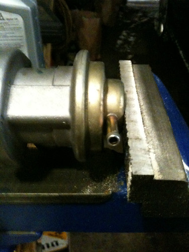

I went ahead and further crushed my IX BOV last night.
Here it is with its 'mini-crush' on it. This is with the top crushed about 3-4mm from stock, and how I had it at the start of this test:
Here is after further crushing it. I mushed the top down to the point that the nipple sticking out the side firmly started to touch the outside rim, probably another 5mm from where it was before. Once I was done, I stuck a needle-nose in the end of the nipple and bent it up just enough to easily get a hose back on it all the way:
From this angle, you can sorta see how its become concave:
Just thought I'd share, this technique is officially 20 years old at this point! Comments on driveability changes in a few days.

Originally Posted by Steve93Talon
Why are people still crushing BOVs? Properly modding by eliminating the fast release port will allow the valve to hold more boost than crushing, and will allow greater opening of the valve since you're not shortening the spring height.
http://www.thedodgegarage.com/turbo_bov_mod.html
The effect of shortering the spring by crushing the BOV is similar to what a MBC would do. Shortering the spring will initially make the spring stiffer, it is always harder to compress a spring when is already compressed.
The gains are there, DSM people always had good results however is a double edge knive, crush it too much and you will loose boost. A little crushing is always good. my .2c
Carlos
You might have over crushed it to much will cause surging..
