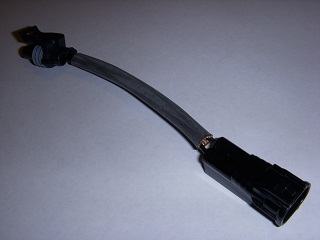

GM 3 port does not need to be "soldered in"
There are P&P harnesses available.
$40 for the GM 3 port and $20 for the harness

Can it be mounted in the stock location or does it need a special bracket?
Any pics of mounting options?
And yes I live in cali where a good ref will check EVERYTHING, so I don't want to zip tie things
