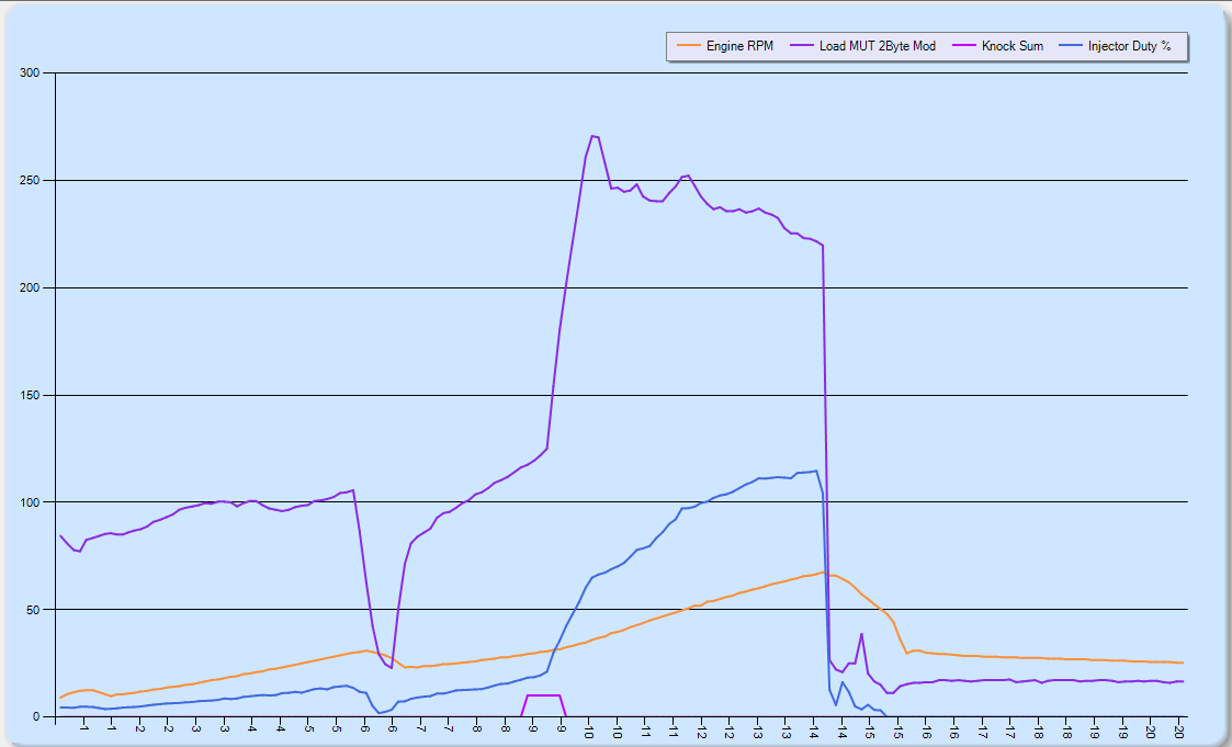

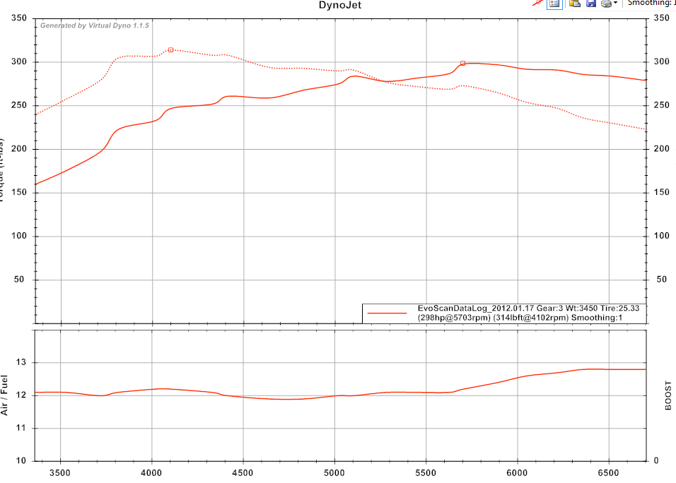

I just installed WB a few weeks ago and i have m made a few runs trying to work on fuel maps. I first tried to tune with lean spool enabled and couldnt get AFR's rich enough were staying around 12.5:1 from 4K to 7K. So I disable lean spool and have been attempting to tune without it. I know work is needed on the 3500-5500 RPM range, but no matter what I change tables to from 5500-7000K i keep getting super lean AFR's. here is my current fuel map, yes I know once I get target AFR's I need to do some smoothing work, but then issue is I am having trouble getting target AFR's during top end without going into 7's on fuel map. Any advice is appreciated? My only thought is stock injectors are maxed.
Boosting peak around 24 and tapering to19-20 with no knock.
Mods are in sig minus UICP/LICP running stock UI/LICP, ripped hole in LICP and pulled UICP until battery relocation done.

Your boost reference must be leaky from the fpr. Investigate immediately

I did boost leak test at beginning up 26PSI and it held for a few minutes. Hmm I can test again, just to be sure.
So should stock injectors be able to handle 24PSI?
