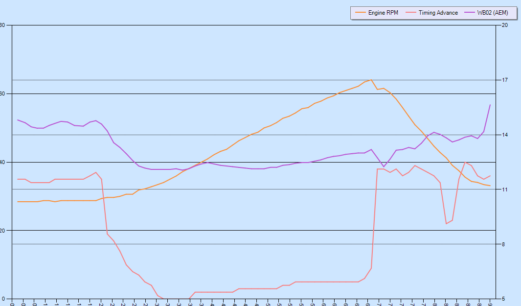

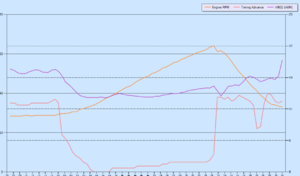

Ok fixed vacuum line from FPR to mani, ran two 3rd gear WOT runs and AFR still super lean up top. Any other ideas?
Just to verify I believe I disabled lean spool correctly, maybe someone with more knowledge could verify. Tables added
<table name="Lean Spool Start RPM" category="Fuel Lean Spool" address="1280" type="1D" level="1" scaling="RPMStatLimit"/>
<table name="Lean Spool Stop RPM" category="Fuel Lean Spool" address="1284" type="1D" level="1" scaling="RPMStatLimit"/>
Start and stop RPM values set to 1500 and 1500
9* at 6500 19PSI at 6500
Found a post where people were experiencing similar issues and resolved replacing fuel pump relay. Will give that try as well.
Attached Thumbnails Fuel Map Tuning Help-leans.png   Fuel Map Tuning Help-graph.png

Def something in the system that tells the fuel pump to go full bore. That small line i mentioned is common especially with the age of our cars and crappy rubber vac lines oe. Check or test the relays, your on the right path.
