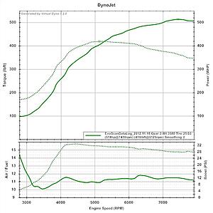

I've been working with Tom over the last few days, and with my busy schedule it's all be on his off time (at night, weekends, etc), which I am grateful of.
The car was being a pain in the *** dialing the 2150s for idle/cruise but now everything is great and making good power.
A quick run down on the car, it's a built 2 liter with stock compression and an FP Red that's journal bearing and the larger cover. 32psi, 93 oct. The car is setup and ready for e85 this is just my tune for when I can't get e85.
At 32psi, it made 514hp/419tq which from what I've seen is more than most Reds on a 2 liter/stock compression. I'm really happy. Can't wait for e85 now.

The graph: (this is the smoothing i feel reflects the power / max smoothing was 509whp) (temp was 35F)
little leaner around 3500 and it will be finished.

stock head? holy crap that jb Red is doing work. Almost seems crazy it's moving that much air at 8,000rpm. You've got to be thrilled with the cars performance

Stock in terms of port work, yes. Has an upgraded valve train and cams though.
