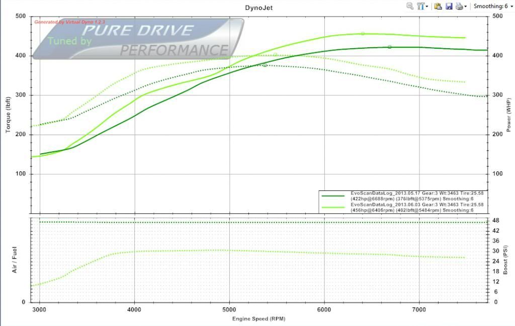

First of all I'd like to thank Anthony for the nice words and review! He was easy to work with once he got over his skepticism of remote tuning.
Like he said I first started working on his idle problems. He rewired his fuel pump, which is causing too much fuel pressure at cruise and idle. We're waiting on SpoolinUp to do a plug and play version of MrFred's Low/High Rewire mod. Regardless, I got his idle to be very stable and no more stumble after WOT or when coming to a stop.
Once we got the idle situated he sent me some WOT logs. The only thing I've been tuning at this point was his idle, all closed loop.
He didn't have his Zeitronix WB hooked up for logging, so I remote accessed his laptop and got it to read in EvoScan. Turns out he was running really lean at WOT! His timing wasn't bad nor was it good, it was ok. It's just too bad he's been running so lean for a year!
His knock settings were set to rarely go off. That bothers me, but I see it a lot. So far every customer I've seen with this is none the wiser. And why would they? They trust their tuner.
At that point Anthony decided to take the plunge into SD tuning. He added the extra parts that he mentioned above and we were off tuning. Everything went really smoothly. I remote accesses his laptop for the first part of tuning. He was off and driving in an hour to log some boost. We've been fine tuning, but everything went really great!
For some reason Anthony and a lot of his friends are stuck on Mustang Dyno #'s. Of course, most of us are using DynoJet #'s, so I threw both up there. The Lime Green line is after I tuned it and the dark green is his baseline on his previous tune. I was a little worried that with it being so lean in his previous tune that he'd get some extra power and screw up my overlay
Anyhow, with safe AFR's, better timing and on SD (no knock BTW) he gained some HP/TQ. I like his thinking too, because we could get a lot more TQ out of this, but he had me set up his ecu boost to control TQ to under 400TQ and to slowly build up boost.
He also has a spare 2.4 block in his garage piecing together parts for a build. Once he get's that put together we'll see some high HP/TQ at least for road racing (no drag here).
Last edited by PureDrivePerformance; Jun 10, 2013 at 03:56 PM. Reason: Final Dyno Graph Update
