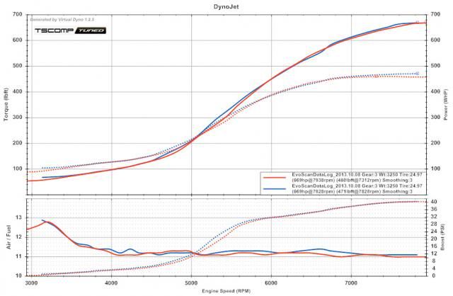

Heres better resolution of the 112octane tune. Keep in mind if we can log data up to 9000RPM the car should be over 700whp. The evoscan cut us short at 7968RPM as usual on 1byte RPM, but you can see the car is just getting started. We will do a 2byte RPM log and post it up in the next few days.
I gradually added boost as the RPM's climbed to keep the torque flat and controlled. We both agreed to keeping the torque down to keep the rods happy. Im sure the rods are fine but never hurts to be super safe.
The 112oct graph: (17* uptop, but the log cut short wont show full power)

That spool looks pretty lazy. I am running a .63 hotside on mine and I can see 20psi by about 4800 in 3rd gear, and 4300-4400 in 4th gear on a 2.0. Is the only reason you are making it that lazy because you don't want the eagle rods to explode?
Anyhow congrats on the results.

Thanks Boz
I didnt do anything to delay the spool. its just that laggy. It is fully spooled by 5600RPM.
Ya 20psi @ 4800RPM is way better then this car is doing.
What cams do you have? this car has S3's which really hurt spool on a 2.0L
34psi pass we just did at the track and he went 132. i am going to give him more boost now.
We had to lower the boost because it was picking up knock. I lowered timing & boost. Hes still at track.
