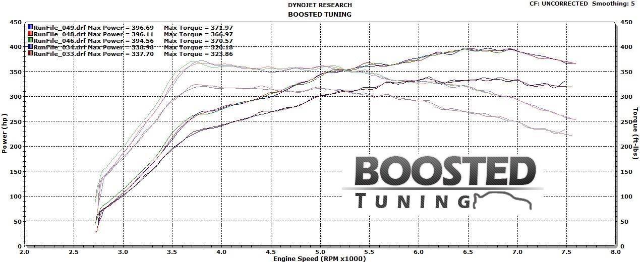

I had the pleasure of tuning this low mileage EVO 9 last week. Awesome to see such a low mileage EVO 9. Boost leak test revealed that it needed some TB seals but then it was ready to tune. Only TBE, intake, GS EBCS, walbro and 1000cc injectors.
25psi on 91oct and 28psi on E85

damn super clear 18k miles

Excellent power numbers for both types of fuel.

Very nice numbers indeed. What did the timing look like up top in comparison to the boost levels? Was there much taper in the upper range?
