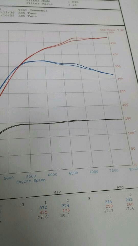

hx40 evo9 boostin performance tuned
I have a stock block evo 9
Hx40 60mm .63 t3 w/ ams hotparts
3"catless exhaust , arp studs
Tial 50mm bov, tial 38mm wastegate
Walbro 450, stock lines and fpr
Fic 2150s , stock rail
Brian crower 276s. Springs/retainers
Grimmspeed 3port, omni 4 bar
Stock intake, throttle body
Vrsf 3.5" intercooler, buschur short route piping,
On the street it spools quick, 30psi by 5k at the latest. Plus 300$ price for an hx40 is nice too.
I made 476whp 360 tq on e85 at 30psi and 403 whp 340tq at 24 psi on 93
On speed density & mustang dyno
Here's a couple pics of my car
