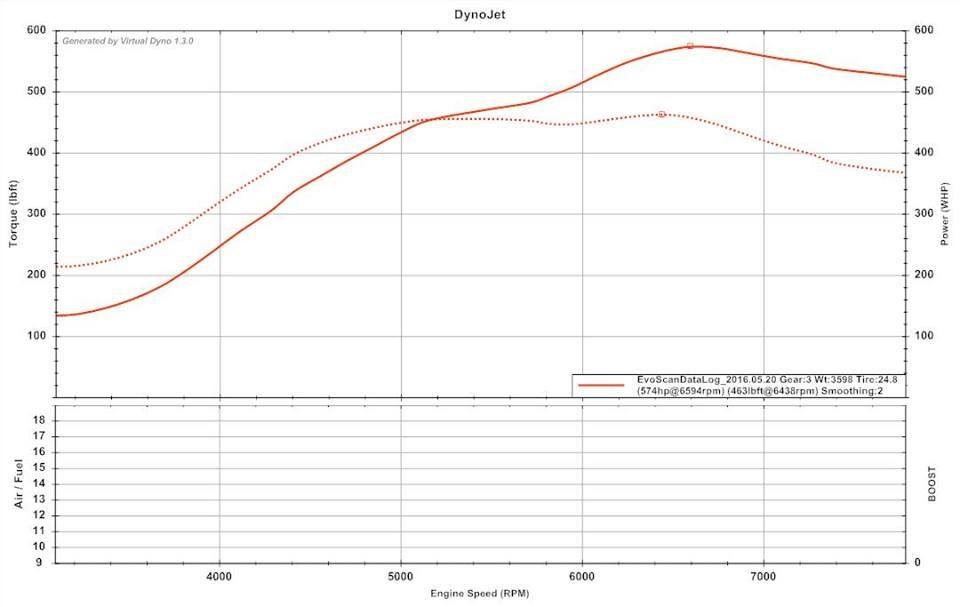

FP Black 574 whp 2.3 self tuned
FP Black
Ported IM
Ported Turbo manifold
S90 70mm throttle
S2
Kiggly spring and retainer
HLA
2.3 Block with Carillo H beam 9:1 compression
Speed Density 3D
34 psi
ID1700
double 255
O2 Dump
Q16 fuel
Car ran 11.3 @ 125 MPH on pump gas at 26 psi making around 450 whp
Hope to get into mid 10s do you guys think its possible? added nlts and launch capability now along with race fuel

I was going to say, only 14 deg on q16... haha. Pretty sure I run 15 on E85 and I could squeeze out more if I really wanted to.
Very nice numbers and setup. How do you like those 1700s?
