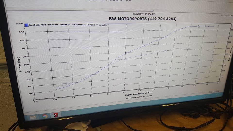

Not sure, I would have to load the file and see.
We did back the numbers up on another local dynojet. @F&S Motorsports, the car put down 955whp first hit off the street on a couple degrees less timing (street map) and warmer ambient temps. Its fairly consistent.
So this is your car that is in CZero Media's video. Awesome work and hope you hit the 1,000 hp mark soon!
