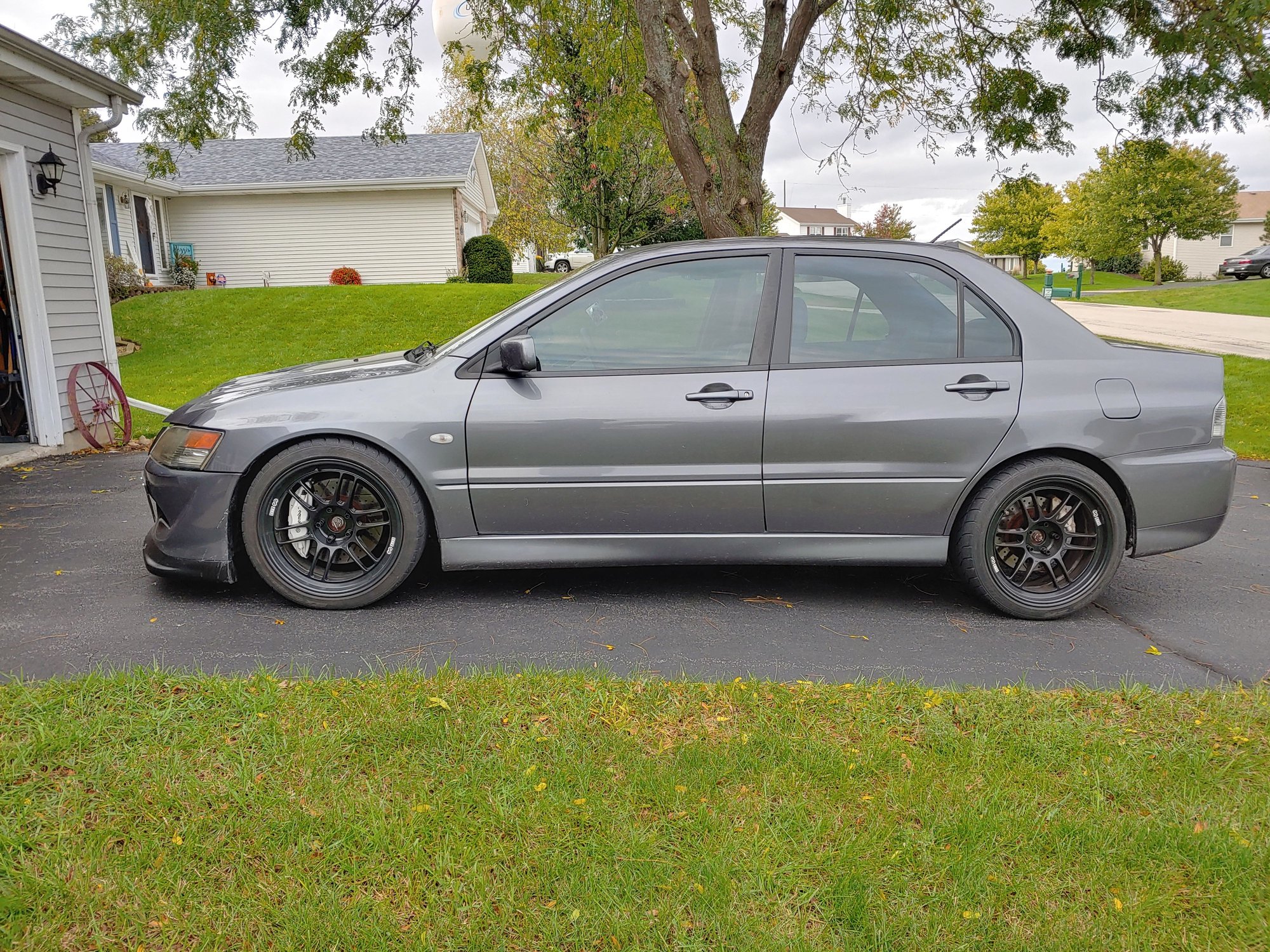

Hi everyone,
I just finished up the tune on this Evo 8 recently and am really excited about the results. Here the details on the build:
Built 2.0 - Wiseco HD1400 E85 10.5:1 pistons, Manley I beam rods, OEM crank
FP 71HTA
Injen IC Piping
TBE
No name tubular exhaust manifold
Synapse BOV
HKS 272 cams
Speed density tune on E85
I haven't seen a lot of results posted about the 71HTA so just thought I'd share. Pretty amazing what this turbo can do when you put it on a built motor.
