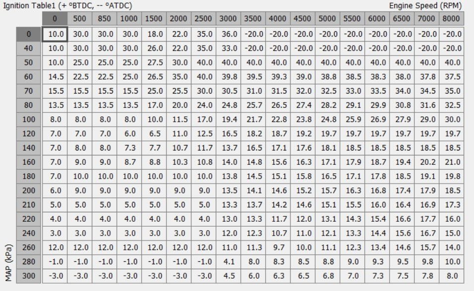

Had my Evo 6 tuned on E85. Engine is unopened all stock internals. Running a TD05 18G Kinugawa Turbo, 1000cc injector, 3" exhaust, 460 walbro and Vipec Plugin V44.
Heres the Ignition Map, does this seem fine for a stock engine?
Stock engine, 20psi, E85
