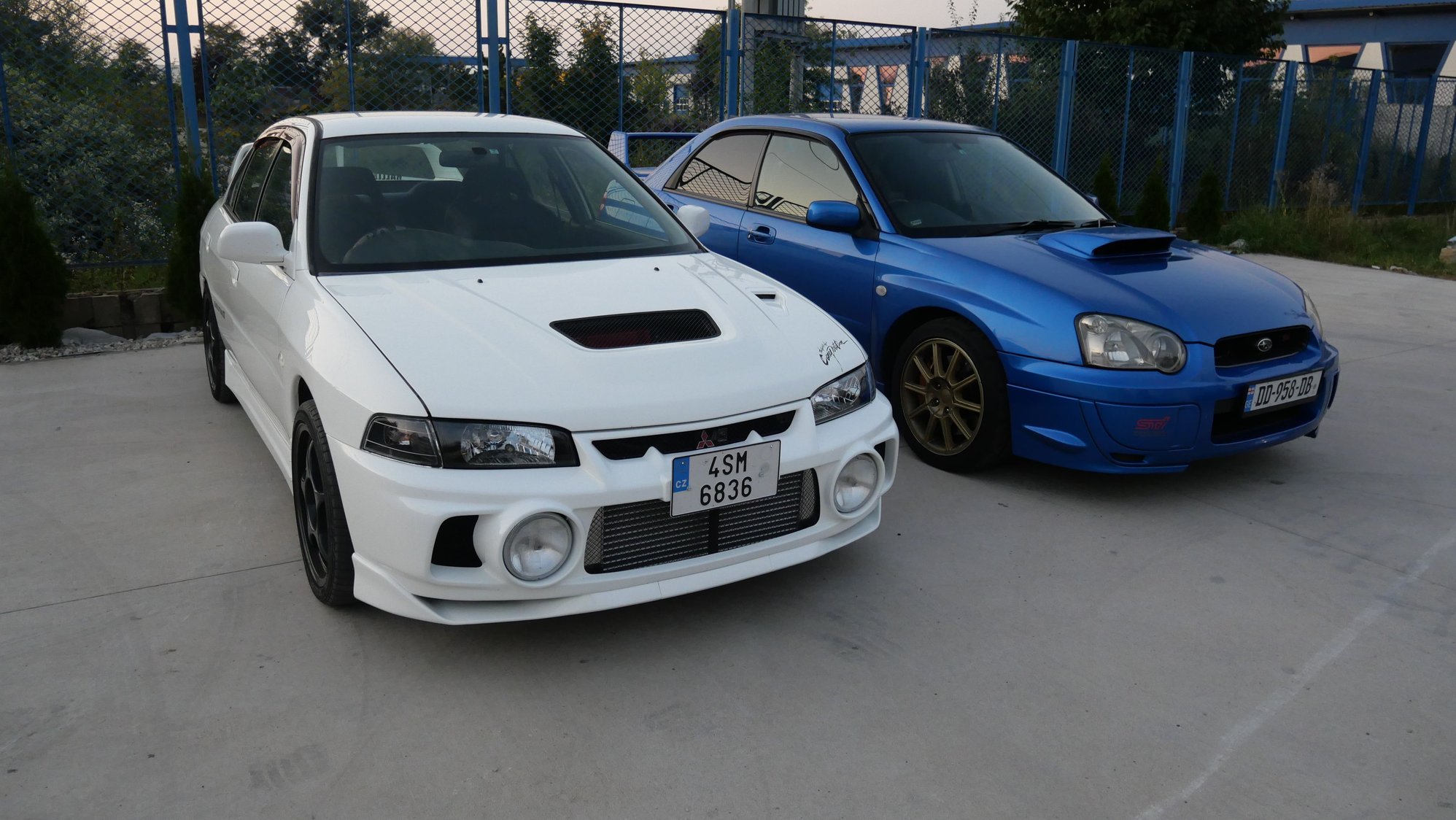

EVO 4 450Nm 390HP
stock EVO4 engine
stock injectors
Greddy intercooler
3" turboback exhaust
2.5" staight intake
K20 coils
MAC solenoid
LINK ecu
max boost 1.4bar
duty cycle 95%
