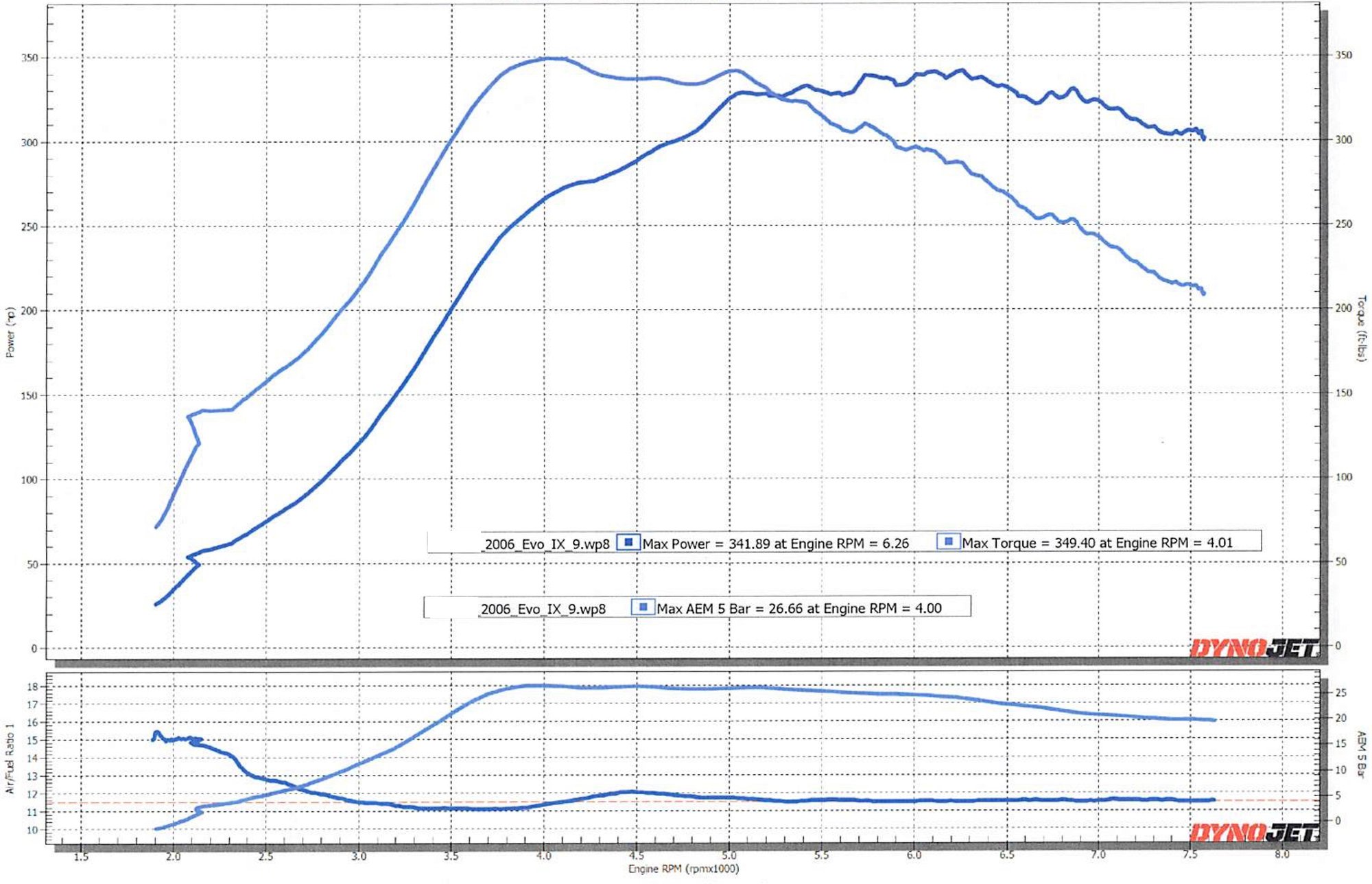

Smile Evo 9 Stock Turbo on 93
Mods:
K&N Typhoon intake
ETS 3.5" intercooler
ETS 2.5" LICP
MAP O2 eliminator downpipe
Tomei catback
DW300 fuel pump
ID 1050x injectors
GrimmSpeed 3-port boost solenoid
340 HP
350 TQ
I believe the stock turbo is maxed out on 93. I only plan on tuning this car on 93 because E85 stations are limited where I live. I am still running the stock clutch, which conveniently also tops out around this power level.
The car drives just as well as it did when it was stock. Power delivery is smooth throughout the entire rev range. I don't know why the dyno graph is jagged at higher rpms. The biggest difference now compared to stock is that the car feels like it's accelerating to redline, whereas before the power felt like it fell off around 5500rpm.

8 or 9 engine?

im guessing its an evo 9 as the dyno graph days 2006 evo IX on it

Good Numbers for the mods you put on.
