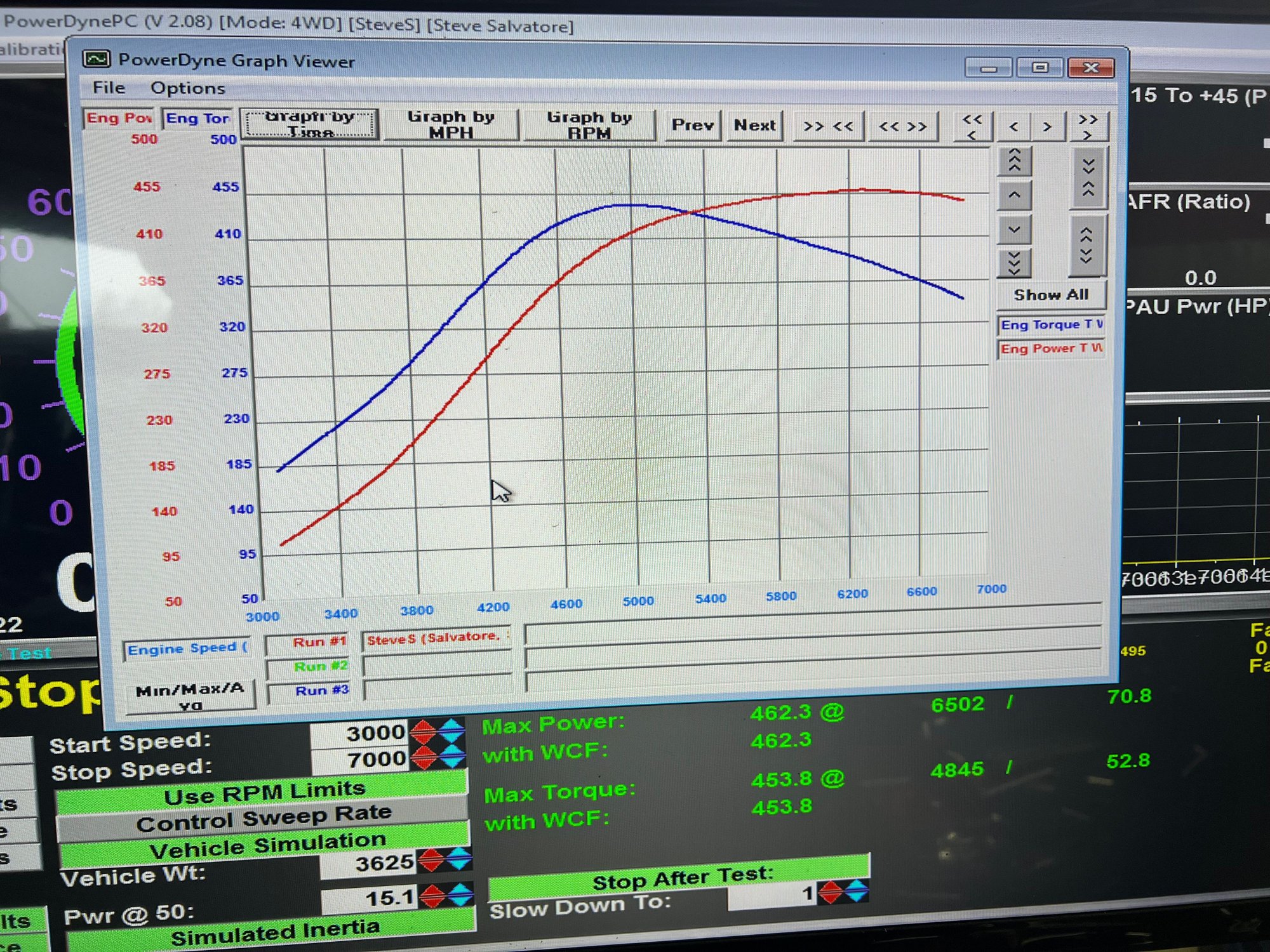

Have any pictures of the graphs?

@deylag heres the pump gas chart. I’m an idiot and forgot to get one of the E85 pull.
