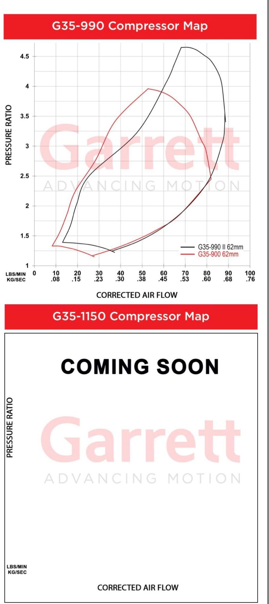

looking at the gen 2 compressor maps it seems that they sacrifice a little down low or are not as wide in return for top end. I would like to see these in action to really see if I would like to change in the future. The g35-990 would interest me if it provides better low end and about the same power
If you compare the G35-990 to your G35-1050 there’s definitely less flow at lower boost, but that’s because the compressor wheel is 62mm on the 990 vs 68mm on the 1050.
Looking at the gen 1 62mm vs gen 2 62mm there is essentially no loss. I am curious how the Gen 2 68mm compressor map will look when Garrett releases it. All the other gen 2 maps have essentially no loss of power on lower boost as well.

I went looking for the compressor maps again but could only find the g35-900 vs 990. I know I have seen the 1050 vs 1150 before.
I do plan on adding a speed sensor to monitor that in the near future. Also keep in mind that on the dyno we didn’t go past 42psi.
I add the compressor map to show what I meant by the they sacrifice down low and is not as wide in some parts but gain more flow. It looks more peaky. I’m not really sure how to factually interpret the compressor maps so I may be thinking of this all wrong haha

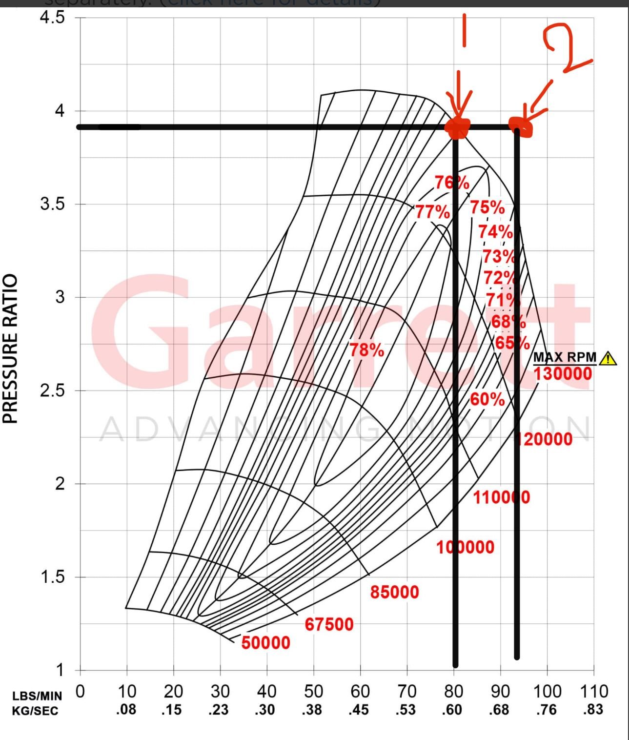

As for the map, ya it can be confusing haha. You are right that it is more peaky. This tall and narrow map is actually a good thing for small displacement motors like on our evos.
How far left the map goes basically shows the least amount of flow a turbo can make at a certain boost level before surging (flow going backwards because it is producing more than the engine can eat). An example I experienced where a further left boundary is needed is when I was playing with rolling anti lag at lower rpms on my Supra. It basically created too much boost and the motor wasn’t at a high enough rpm to suck it all in.
G35-1050 Map
G35-1050 Map

Originally Posted by sunnysideup
Sorry for the giant explanation below haha.
But ya, I hope they release the G35-1150 map soon. And nice that you plan to add a speed sensor. It will definitely help you know how far you are on the compressor map when your car is producing peak power. If you are at sea level, 42 psi is around 3.8 to 4.0 on the pressure ratio axis on the left. So on your G35-1050, the turbo will flow around 80lbs/min before it overspeeds. I plotted where you might be on the G35-1050 map I posted below. Point 1 is theoretical max of the turbo at 42psi before overspeed. Point 2 is where you might be according to your power levels (~95lbs/min). Rule of thumb is 10lbs/min for every 100 crank hp. This changes based on factors like efficiency, DA, back pressure etc.
G35-1050 Map
G35-1050 Map
nice! Thank you for the clarification. I was kind of thinking around the same thing but was a little confused I guess. Looking at how you plotted it I am definitely pushing the limits on this turbo haha. I need to get that speed sensor soon

Absolutely get the speed sensor if you're going to push the turbo to the edge. And from rough numbers, you're already overspeeding the turbo. Keep in mind the compressor pressure ratio on the compressor map is measured as the ratio of compressor outlet vs compressor inlet. The pressure at the compressor inlet drops due to intake (filter) restriction and the compressor outlet pressure is significantly higher than intake manifold pressure (pressure drops from intercooler and plumbing). As an example, you're seeing 42psi at the intake manifold. So, that's maybe 46psi at the compressor outlet gauge pressure, which is about 61psi absolute pressure (14.7 psi atmospheric, rounding up a bit). And your inlet pressure has dropped about 3psi, call it down to 12psi absolute. 61/12 = 5.08 pressure ratio.
The turbos will hold up for a bit if you over spin them, but not forever. The compressor wheel is designed to be strong enough to 'last forever' at the max rated speed. If you spin it faster, you're going to stress the wheel more and shorten its life. It's like if your engine has a redline of 8k rpms, but you spin it up to 9k. It'll hold up for a bit, but eventually blow up.
