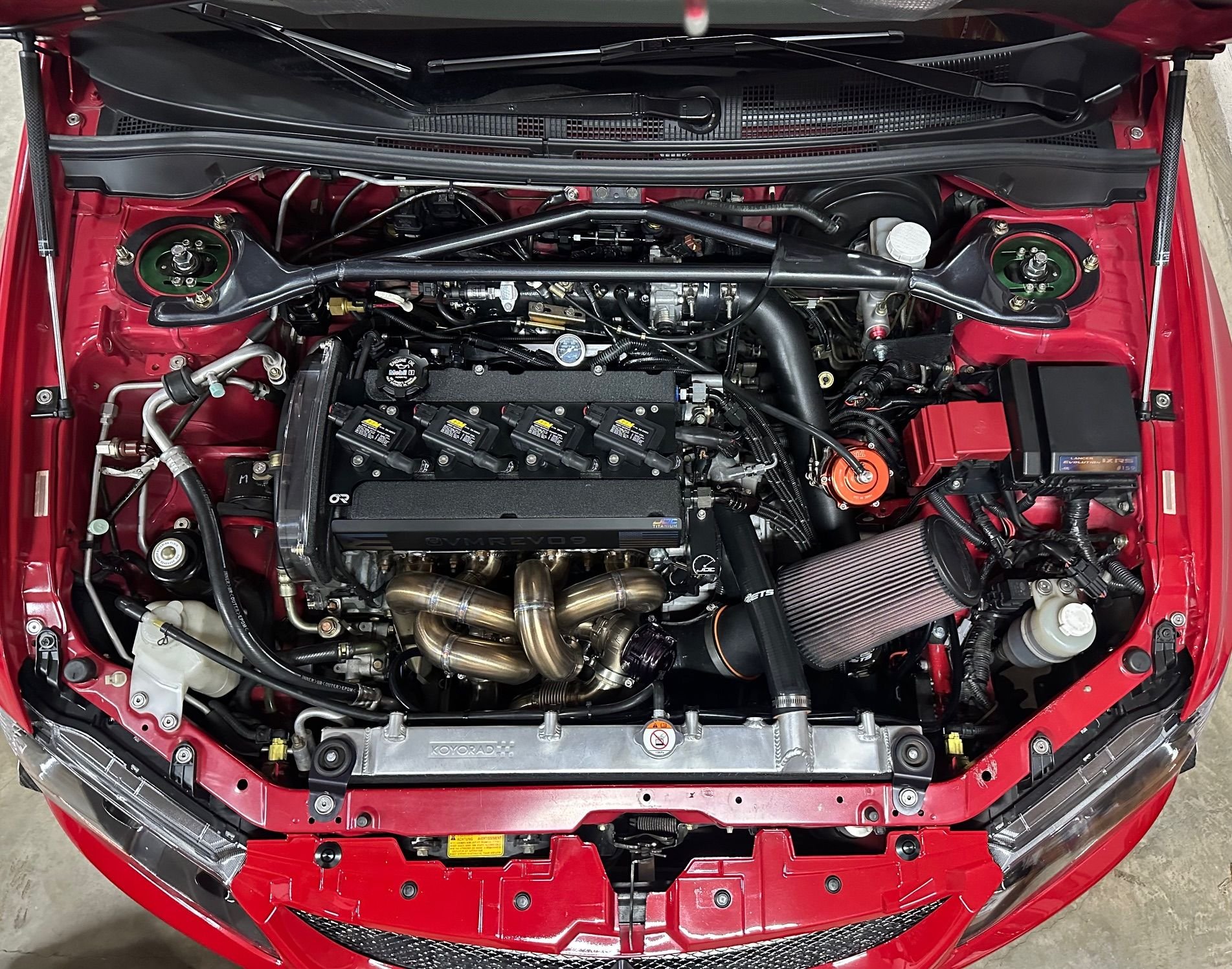

It's been a while since I have posted anything so I figured I would post an update on my car with its newest version. I've owned this car since 2006 and have always dreamed of doing a big build. There have been a few different 'mini" builds throughout the years but it was always on a stock block, stock ecu and GSC S2 cams and power ranging from 350hp to 517hp.
Current mod list:
BD Alchemist built 2.0L
BD Alchemist refreshed head with Ferrea valves and Kiggly springs
GSC S3 MIVEC Cams
Curt Brown ported stock intake manifold and 65mm TB
Morrison Fabrication V-band dual 38mm wastesgate turbo kit with Garrett G35-1050 .83a/r
Ign-1A Sequential ignition with BD Alchemist harness
TRE built 5 speed with evo 8 3rd and 4th gears and 4:11FD
Exedy Triple Disc
Haltech Elite 2000 with IC7 dash and CANBUS keypad
FIC2150 injectors
3x Walbro 450 fuel pumps (1 in main tank, 2 in Radium Surge tank)
Flex-Fuel tuned

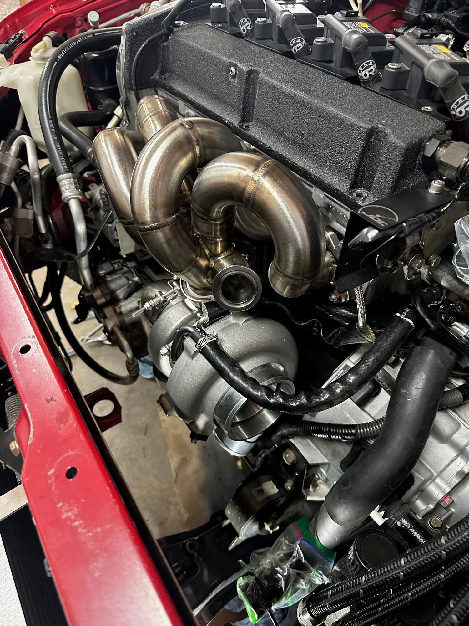

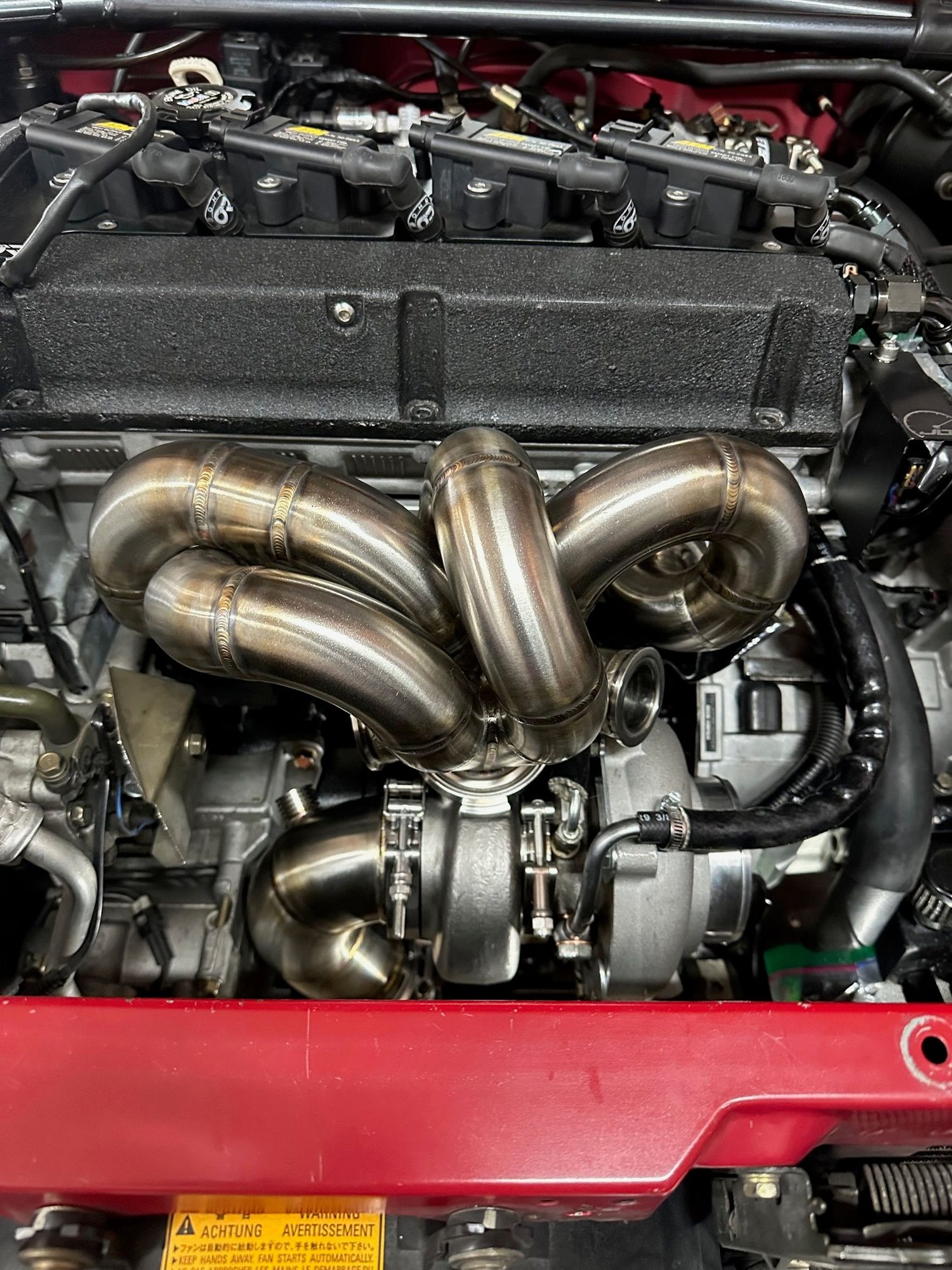

That's a clean setup! The engine bay looks so nice with that Morrison Fab turbo kit! Judging from the mod list it looks like you were aiming for 1000 whp. I heard on a podcast that off the shelf Garrett turbos aren't optimized for 4 cylinder engines, so in order to make 1000+ you will need to run a bigger garrett turbo like something rated 1200-1300.

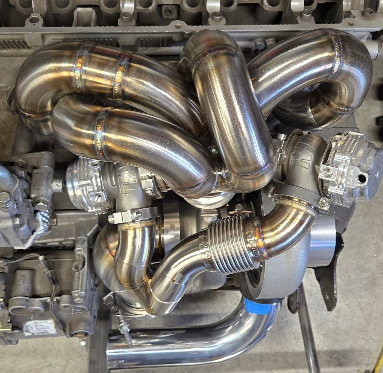

That twin scroll manifold must help a lot.

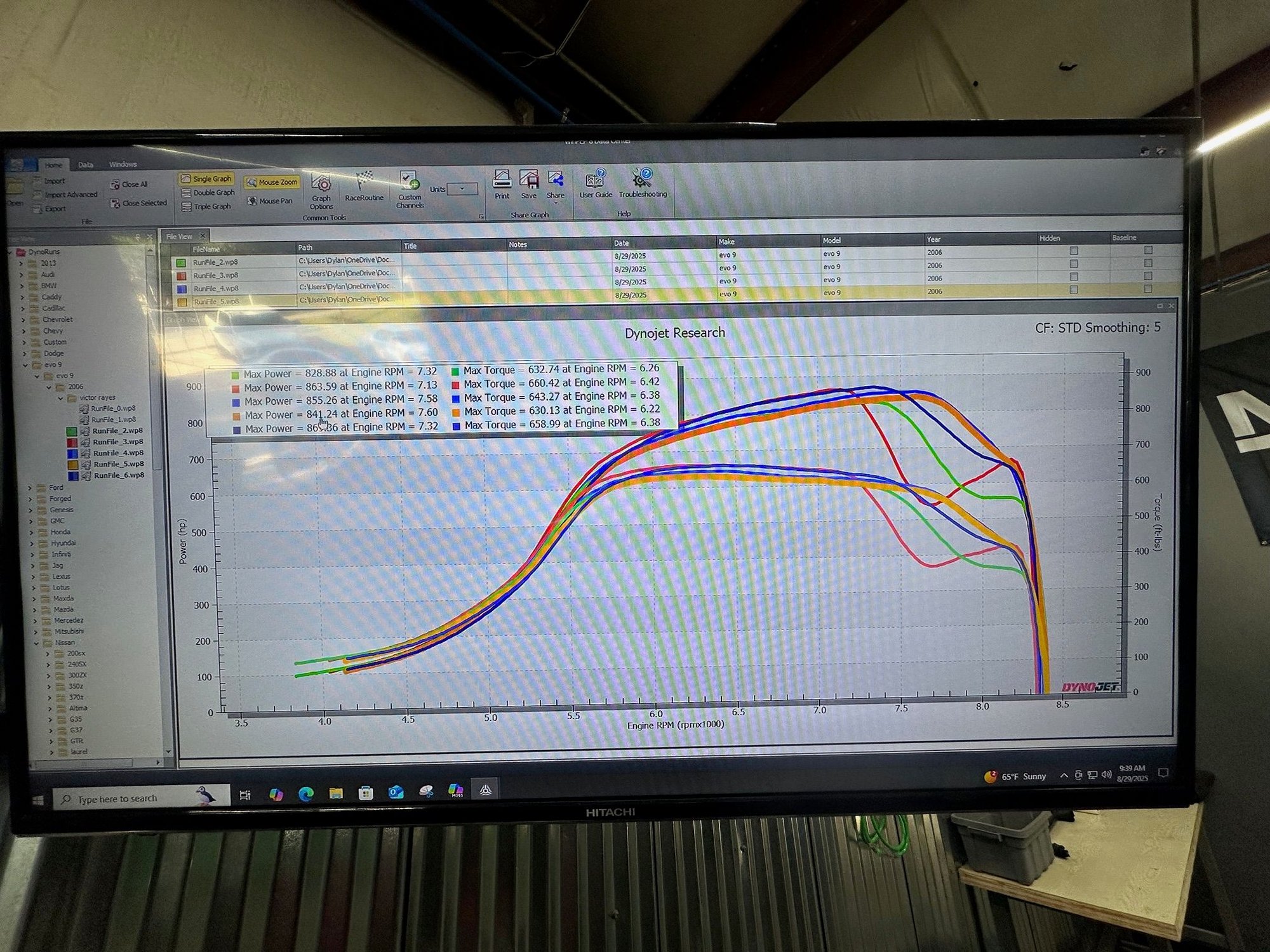

Nice build . It comes up a little (200-400rpm) sooner then a 9569/6869 but falls hard at 7700. Did you measure backpressure? A 9569/6869 goes proud to 9500. Generally the more rpm the faster the car will be. IF the trans will shift. Still looks like alot of fun and your trans will shift much better at 7-8000rpm. Your stock intake is helping on the low end, but may be a bottleneck up top.
It's not twin-scroll; it's a single scroll v-band based on the pictures.

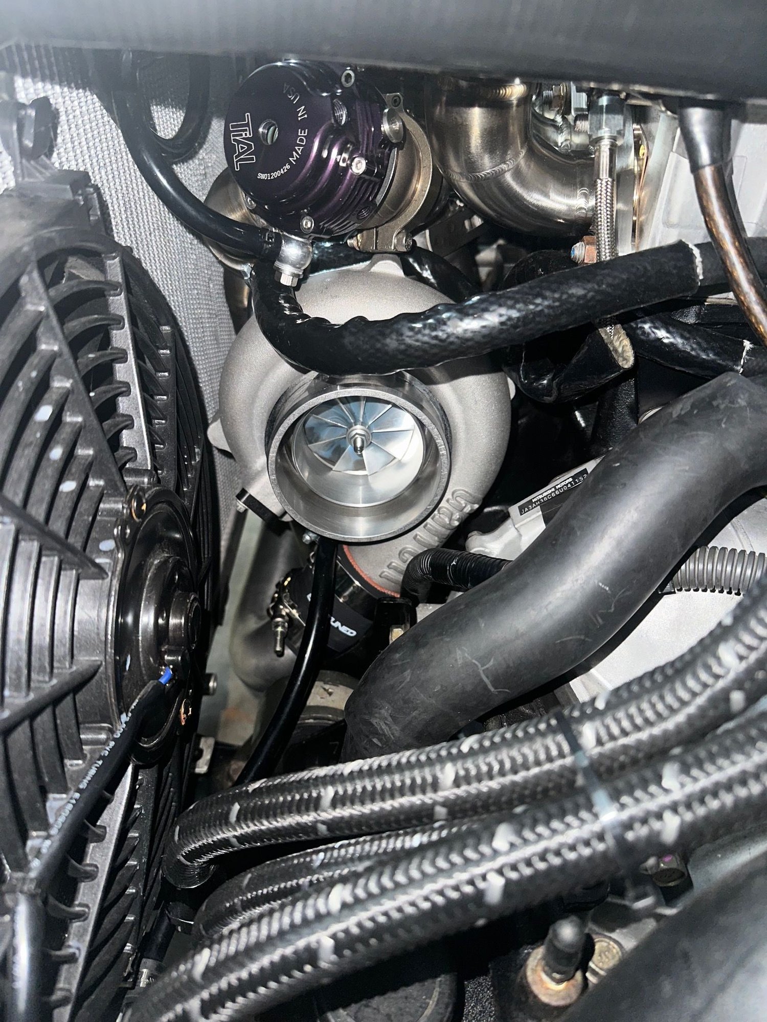

So my tuner/builder built the motor to handle 1000hp but i have no intentions of pushing for it. the car is capable with a bigger turbo like the G42 or similar. I rather have a more responsive setup than what the 1000hp setups tend to provide.
Edit** I must of overlooked this. The current manifold is a v-band with dual wastegates to help control boost. Previous setup was a twinscroll but switched to this kit. Morrison Fab did an amazing job. I previously had a twinscroll manifold that i had tried with this turbo. we had problems controlling "low" boost for pump gas. this kit solved that and looks so much better!
I'm a fan of responsive setups btw.
We didnt measure back pressure. My tuner stated that he didnt feel like it was a back pressure issue according to the logs and the way it was happening. But i will be adding a sensor in the future along with a DBW setup. I do wish it had alittle more response down low but when this turbo lights up its insane. My tuner and I were discussing the manifold and he suggested maybe going to a Skunk2 as i do not want to go bigger and sacrifice low end. I dont think i have seen many on a ported stock intake at this power level.
You are correct, its a v-band with dual wastegates

Also I am curious why you chose to go V-band over a twinscroll? I would expect an extra 2-300rpm of spool with similar top end if you have the largest divided housing

Yes there is a big difference in spool and off boost characteristics. Comparing the g35 to the 6266 even while both being twinscroll the g35 is “lazier” down low but to be expected as its bigger.
overall driving it’s fine but with any 68mm turbo its takes a bit for the boost to build especially with the bigger cams.
I went v-band because the twinscroll housing was too small for the g35. The only option available is a 1.06 and it choked it up top and low boost was hard to control. These turbos were designed for v-band
