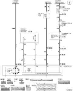

hey guys i have ran in to this problem on a guys car i replaced the alt thinking that it was the problem becuse all sings point to it but it was a remaned alt i also checked the wires that controll the voltage regulater and they all seemed to be with in spec as far as the resistance in the wires here is a diagram that i used if needed i will tell step by step of what i did to come to the conclusion that it was the remaned alt new alt coming from mitsu
