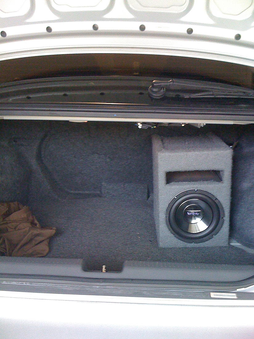

UPDATE: I received the 8' infinity 860w in the mail today and plugged it in and it seems to work fine withe the stock amp. However I think it will be to much work to try and fab it into the stock sll box and keep it sealed, so im just gonna build a nice ported enclosure for it. I will update with pics and how it sounds when im finished.

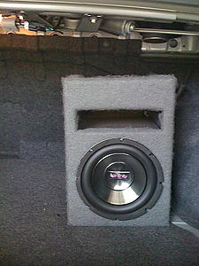

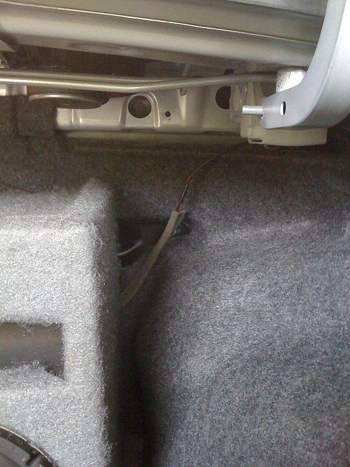

Ok so here are some pics. if your stock woofer has blown or want something that sounds a little better and dont want to upgrade head unit amp etc. then this is a great alternative, all you need is about $100 some carpentry skills and or know someone who does. At first I wanted to try and fabricate this woofer into the stock ssl box but realized it would be to hard to do so. Biggest problem having it remain as a sealed enclosure. So I figured it would just be easier to build it a nice ported enclosure to spec. It sounds good! not a whole lot lot louder than stock, but defiantly noticeable! In the last pick you can see how I used the factory bracket to mount it to the back of the car, still need to do the other side though.

It shouldn't play louder than stock, because you're using a less sensitive driver. Without knowing the nominal impedance of the original woofer, we can't say for sure whether the x-over point remained constant, as well.
Folks, if you want a replacement woofer for the SSL sub, we need two crucial pieces of information - the volume of the enclosure and the impedance of the driver (measured in Ohms). There are a gazillion woofers that can be had, each with varying electrical/mechanical characteristics. It wouldn't be hard to find the right driver, and I could model it in a similar enclose, but we NEED the info I described. We could also find an even more sensitive driver, making the stock sub sound louder with less distortion, but that won't happen by shooting in the dark.
